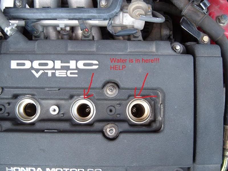

I have water in my spark plug cylinders!!! What would be the easiest way to dry it out?
I wanted to clean my engine bay. I covered the alternator good, just didn't realize that water would seep under the spark plugs so easily. I drove around it almost died on me, before you know it I'm running on 1-2 cylinders.
At least I got some stuff cleaned :)
Picture of hole w/water

More details. In the cylinder or only sitting above the spark plug?
EDIT: And when this has happened to me I used a drinking straw

You have a bigger problem with the block than with the spark plug cylinders.

Originally posted by: ballmode
It is in the spark plug cylinder, not the engine.
You mean there's water where the spark plug normally is?
To make it easier to understand, what exactly happened?

Based on your pic/diagrams, the water is not in the cylinder.
Water is not going to get into the cylinder if the plugs were seated properly.
I think you would be best to just start the engine and let the natural heat evaporate the moisture.

Well I did have it working but the throttle response sucks. Engine shakes alot too... any suggestions?

Yes, it still is damp, it will dry out itself given time, or else pull the spark plug boots off the plugs, shoot boots with WD40 inside, and also down into holes and over spark plugs, may take awhile to dry being they are way down in there
