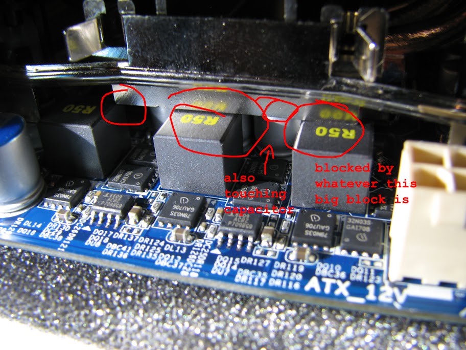

Long story short, I have my Gigabyte P35-DS3R motherboard and I have my Scythe Mine. I put the two together today to see if they would fit in my case. It did (barely), but now I've run into another problem.
I noticed that the Mine was not seating as firmly as I thought it should have... so I took a closer look.
On the side:
uh oh
The bottom of the heatsink is touching components on the motherboard. This may not be a problem in itself but here's another picture, 90 degrees counter-clockwise:
Picture of the socket 775 mounting pins
Because of the blockage seen in the first pic, two of the mounting pins will not lock all the way down (only about halfway). I know these provide pressure for the HSF/CPU connection, so I'm concerned here.
I thought about turning the HSF 90 degrees so that I wouldn't have this problem, but then:
oh noes
In this position, the block on the other side makes it completely impossible for the HSF to seat at all. This situation is much worse than my original situation, where it actually seemed like it could seat.

Does anyone know if my Scythe Mine will work when it is not seated 100% correctly? Will it work like this? Help!

I know, I mentioned that... but that still doesn't make the mounting problem any different (unless the CPU+IHS will add about 5mm of height to the socket, which I don't think it will do).

Well I do know adding a cpu will not increase ht because it always sits inside that frame thing. So if it doesnt work now it will not work later. Im sorry but I cannot offer any advice but to say return the mine and get something that allows your HS to sit higher
agreed

I'm calling B.S. on this thread, if that's what the OP is saying!
Look, I'm running a Scythe Mine 3 in my wife's machine - used to have it in my machine for like 6 months when Tuniq Tower 120s were on back-order.
The Scythe Mine 3 isn't that big! This guy just tried mounting it with NO CPU present... hello!?!?!?!? No wonder it didn't fit!
Scythe Mine 3 coolers are medium sized, extremely quiet, and work fairly good - but they have the world's worst mounting system (the only fault I can find with them).
Anyway, let's give the OP a chance to respond... ;)

I thought the pictures would explain everything, but I guess not...
You're right, the Scythe Mine is NOT a big cooler. However, if you look at the bottom - the mounting system Scythe used is a major problem. Here's a pic of where the mounting parts are blocked from seating correctly by motherboard components.
When I put the CPU in, it didn't make a difference. The IHS doesn't go above the metal "shield" that clamps on top of the CPU.

GA-P35-DS3R(rev 1.0) + Scythe Mine rev B = OK, no problems at all !
