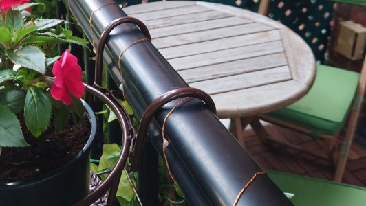

We have this very simple heated birdbath we'd like to install on our balcony but I'm coming up against problems I don't know how to solve...
The photos in that link will show the mounting options it comes with. This is a photo of the part of our balcony/railing we'd like to use for installation but
  • that top railing (covered now by pine branches) isn't flat, it's slightly rounded. So it doesn't take things clamped to it well. If there's another way that's done, I don't know it.
  • the railing's also metal. So there's nothing I can actually screw into with the mounts
  • That is pretty much the only place it can go but the rest of the rail is the same anyway.

Get a wood pole, zip tie it to the railing, screw bath into said pole.
I did that with a bird feeder. The problem is that in summer, this part of the railing has a long lattice board we put in front of it. I suppose you just remove it in spring when the lattice goes up and get more zip ties.

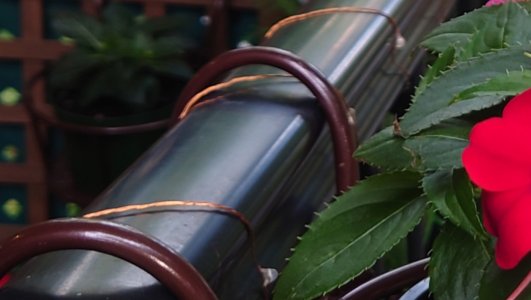

This is what the curved railing looks like along the top in case it's of any help...
3 boards, six wood screws.
Screw the three boards together so you have a flat top with a channel that fits snugly over the rail, set bird bath on top.

Ok, the bird bath can't go on top. Nothing would be holding it in place. It can only be held in place by the mount on its outer edge. And you either C-clamp it or screw it into something but vertically. The photos in the product link show it clearly.
What @Greenman is talking about doing is making a poor man's balcony rail table that rides on top of the balcony rail. If you want to attach the bird bath down, screw a small section of 2x4 vertically to the top of the table surface you make, then use the deck mount option on the bird bath and screw it into the vertical 2x4 section. Would make for easy removal as you'd just remove the whole table.
Alternatively, just buy another small round free standing table like the round one in your pictures (or even an actual balcony rail table) to place on your balcony rail to put the bird bath on top of and call it a day.
So long as it is placed in an area protected from the wind and you keep it filled with water, it shouldn't need to be attached down. If you still want it attached down, though, you could just use velcro strips on the bottom of it.
The solution here would require 3 more much smaller pieces of wood screwed to the top of the shelf to create a bar that you would clamp the bird bath to.
