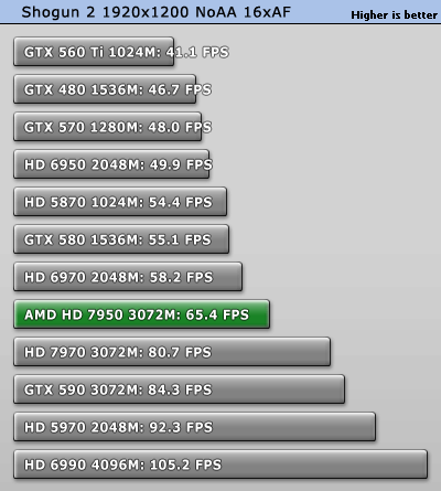

Yeah there are some outliers used here that are representing not straight GPU prowess but memory bottlenecks (BF3 ultra 4xmsaa, metro 2033 and others) and multi-threaded rendering driver advantages (Civ5).
In BF3 GTX560ti 1024MB is faster than HD5870, no Buffer wall here.
In Civ 5, HD69xx series is faster than HD58xx and it seams that HD79xx scales even better. So, architecture play's a big part in the performance.
In Metro 2033, again GTX560Ti 1024MB is faster, no Buffer wall again.
None of the above games needs more than 1GB at single 1080/1200p resolution.
Also, GTX480 and NV cards in general perform poorly in Dragon Age II and especially in Shogun 2, i haven't removed those Games. People will play them with cards like GTX480 and HD5870 today and it is important to know how those cards perform. ;)

BF3 on ultra with 4xMSAA and Metro 2033 on ultra with 4xAA use more than 1GB of VRAM @ 1080P. Without minimums frames you can't use a 560 getting a higher average FPS, a card that in many cases is faster than a 5870, as some sort of indicator that they are not bottoming out and hitting VRAM walls.
Multi-threaded rendering enabled drivers make a massive difference in Civ 5.
Explain this one to me, you think this is just raw performance and not something else ?
I mean really, you think this is just raw performance at work in what is an incredibly underwhelming game if you are just looking on the visuals ? If you want to talk extreme tessellation, the 480 jumping ahead in Crysis 2 looks reasonable considering the ample usage of tessellation in this game, but 100% faster in B:AC ? And you are using this to find your overall average ?
I'm not disagreeing with your sentiment, we knew the 480 was about 20% faster than a 5870 overall when it released almost 2 years ago and again now because you wanted to remind everyone, but your overall summation is incorrect as it's being skewed by said outliers. What is your point in this exactly ? Are you saying you expect when nvidia releases a 28nm DX11 card that this same pattern is going to be followed ? Or do you just want to talk about cards released 2 to 2 1/2 years ago, again ?

About Shogun 2
By what you are saying, i shouldn't have put Shogun 2 in the mix. HD5870 has the same performance with GTX580, really ??
Why you didnt say anything about that game ?? Well it seams that the developers made a nice job coding the game for VLIW architectures and you know what ?? that's fine by me, because there are a lot of people with AMD cards playing that game.
Just because one game perform way faster than the other card, we dont discard it from benchmarks. It really shows us the differences in Graphics Card Architectures. If you dont like to see the differences or you dont play that game/games dont count them. But when we evaluate the performance of a card we need to take in to consideration all current DX-11 games.
Most of the DX-11 games will need more compute power in the near future. GNC is the right direction but im afraid that Tahiti is not enough to compete with GK100. Because of that, GK104, a middle end NV card could perform very close with 79xx series in those DX-11 games.
2012 is a DX-11 year, and you wont see the same small performance differences we had in 2009-2010 with DX-9 games in the mix. If GK100 will double its compute power it will have significant more performance in those DX-11 games than Tahiti. AMD will have to design a bigger chip some time in the near future in order to compete in DX-11 games and in GPGPU.
