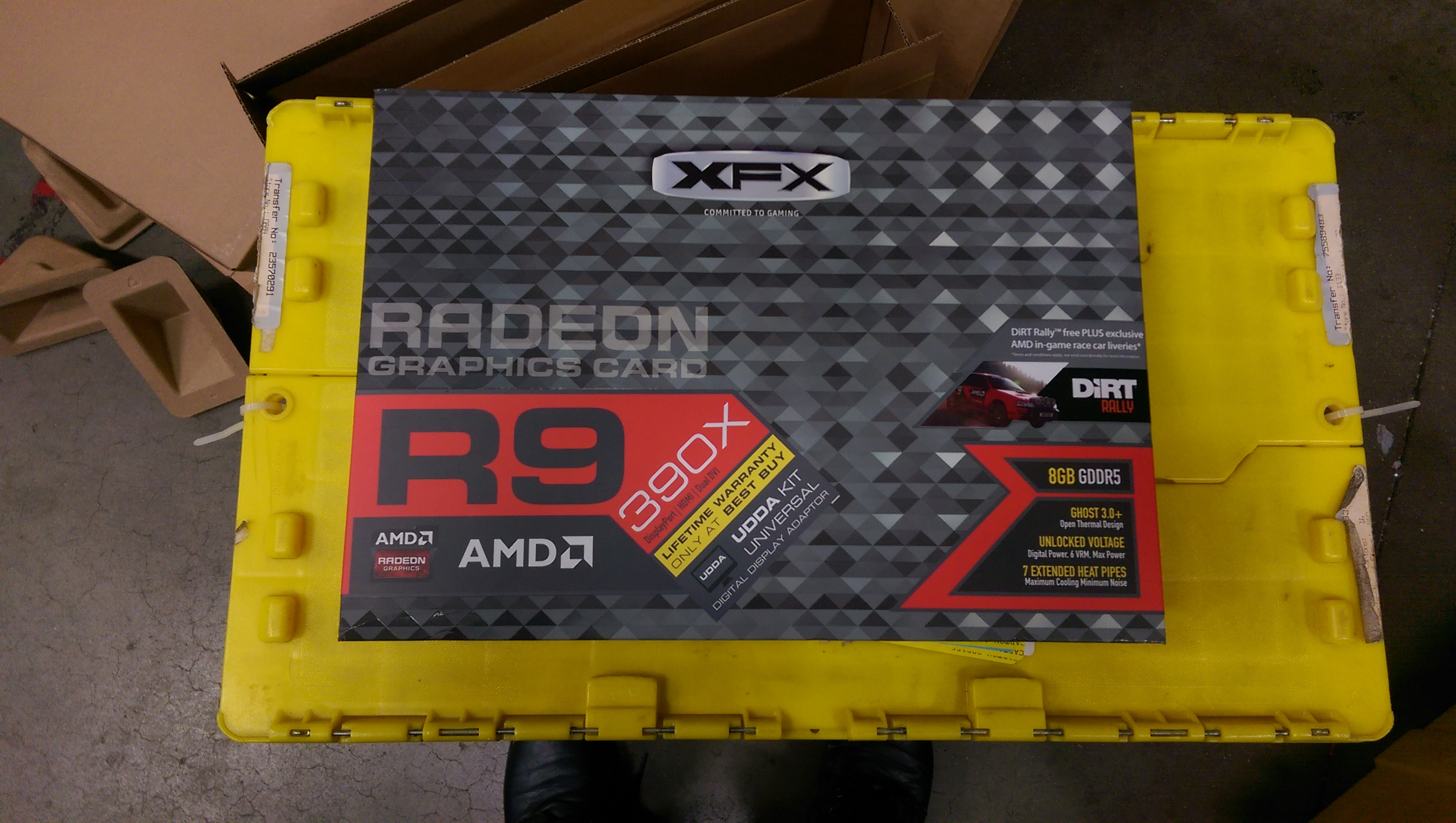

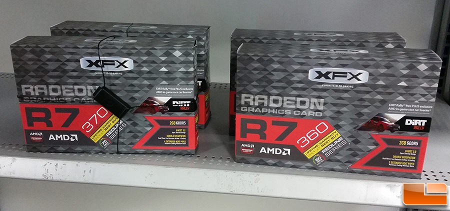

The newest XFX cards do not have lifetime warranties. That ended with the R9/R7 2xx generation.
Fury and R9/R7 3xx are now 2 year warranty.
XFX still offers Lifetime Warranty on parts and labor if the graphics card is purchased at BestBuy:
http://www.bestbuy.com/site/xfx-amd...gray/8278117.p?id=1219690434699&skuId=8278117
This is at least true for R7/9 300 series, not sure about Fury/Fury X.
