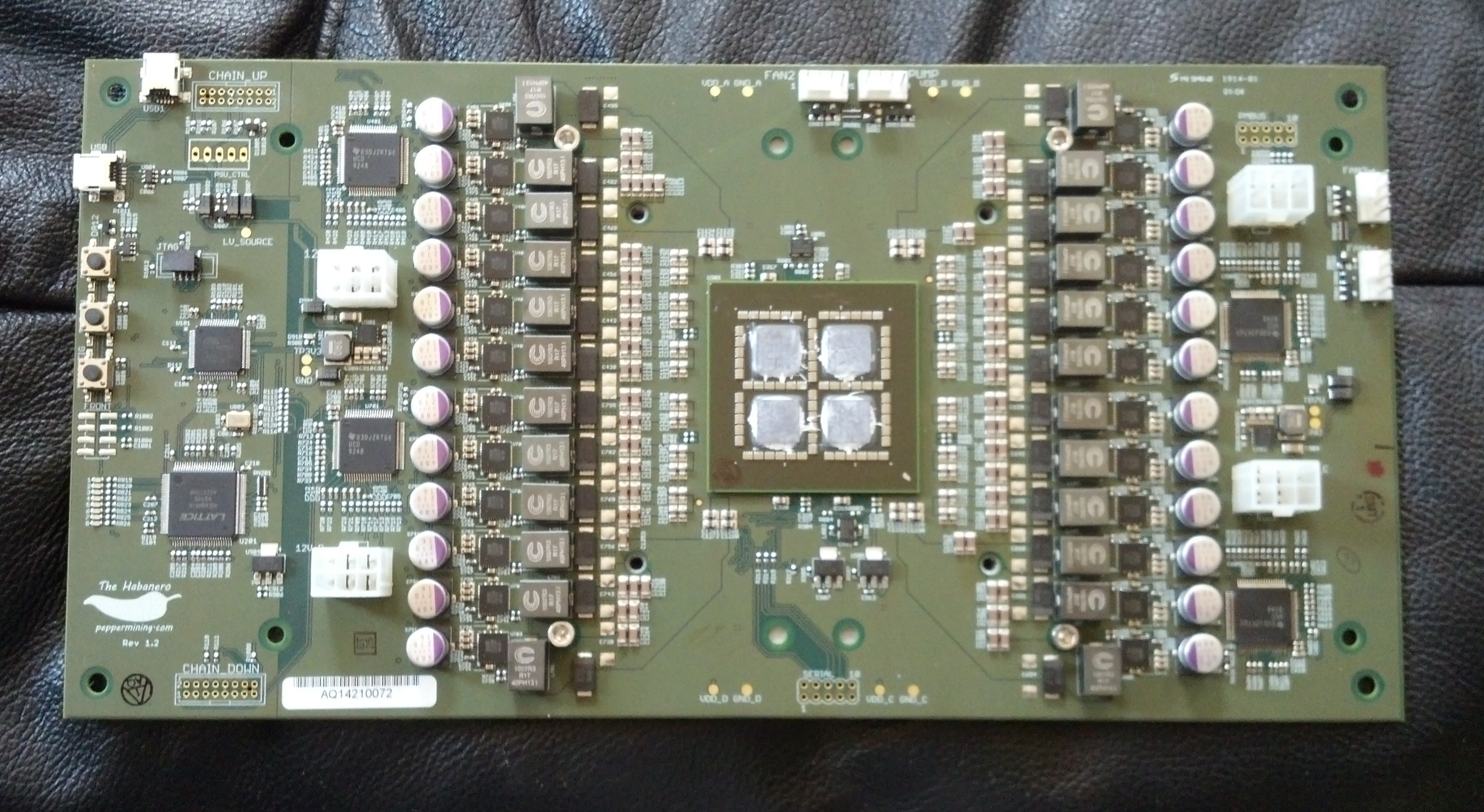

Of course. Really, the cooler efficiency won't change a whole lot based on density, as the heat is spread quite effectively once it's in the bulk of the copper. Higher power density has a large effect on the benefit of better TIM though. When I was running some of my bitcoin mining machines quite hard, I could pull 900W into the board and likely 750W into the chip itself. All that was pulled though a total die area of 324mm² into dual fan closed loop cooler. Switching from the stock paste that came with a Swiftech H-220 to Liquid Ultra would give a 20C difference in die temps.
That was my concern. If the heat could be transferred fast enough with a small delta T.

Well, it's not a GPU. It's four 9mm square bitcoin mining ASICs on a common substrate, each die with its own 6 phase 300A VRM.
/end OT
Just a point that power density in the die to cooler interface can go much higher without issue. Nothing on that board draws any power other than the ASIC and any VRM losses unlike a GPU, so an equivalent GPU power density would be about 3W of (DC) board power per mm² of die area.

:\ that means at 1.23v (usual OC voltage) that chip was consuming 600 amps. By comparison a welder requires only about 80. No way is that possible.
/end OT
