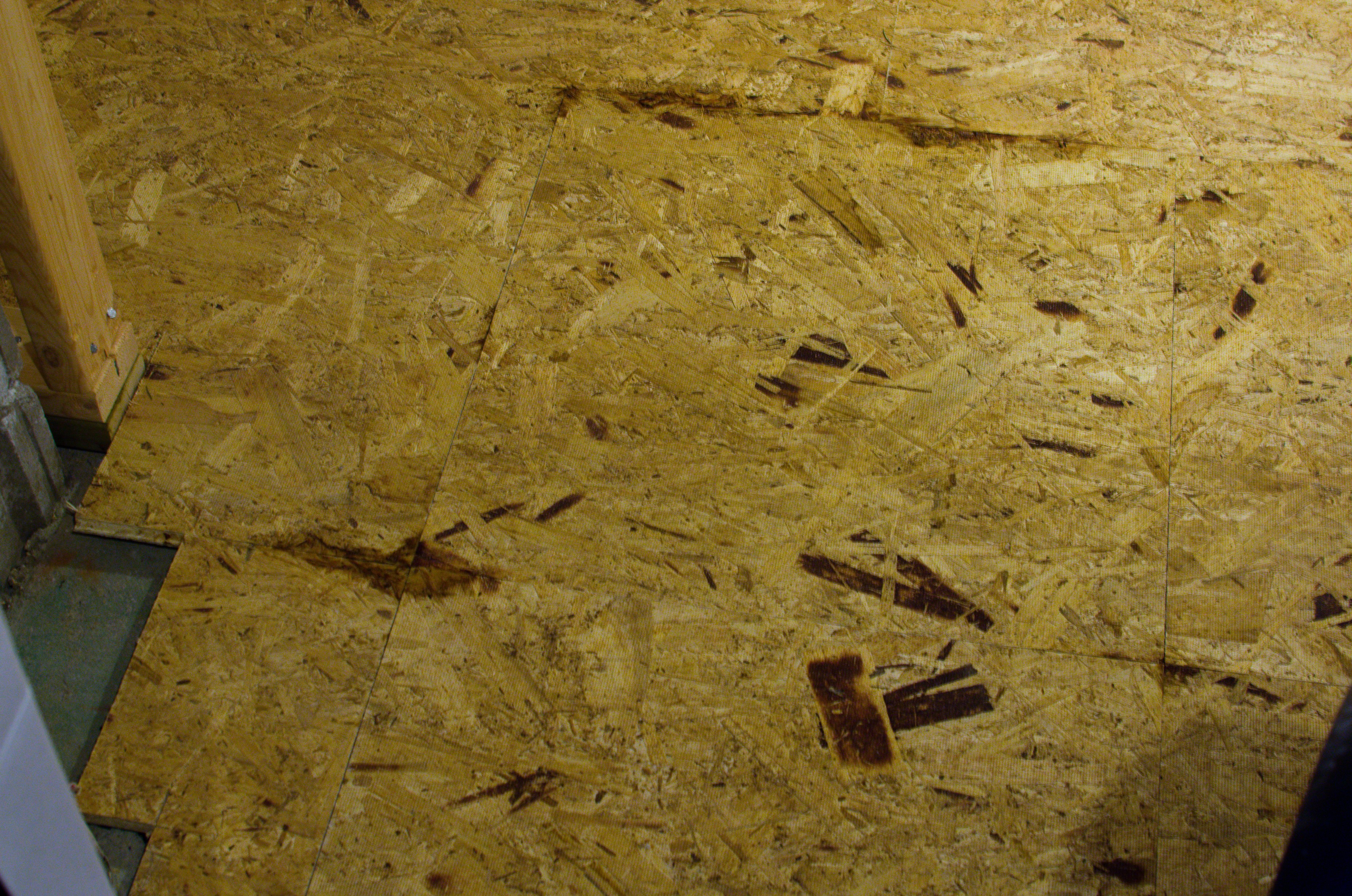

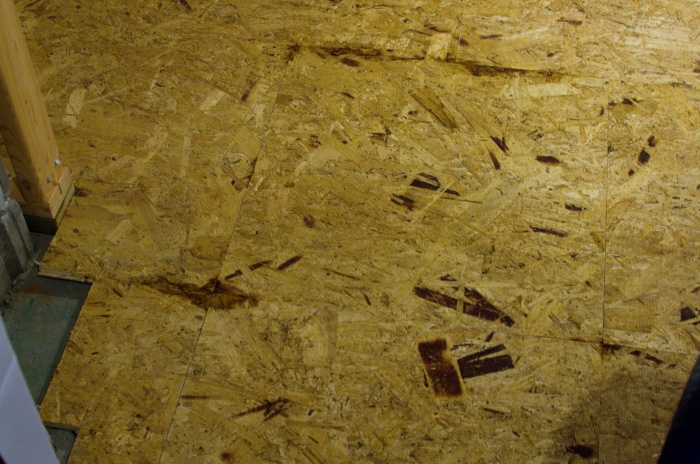

Basically this seems to be the only thing visible that's wet:
Can see the seams where it's darker in two spots.

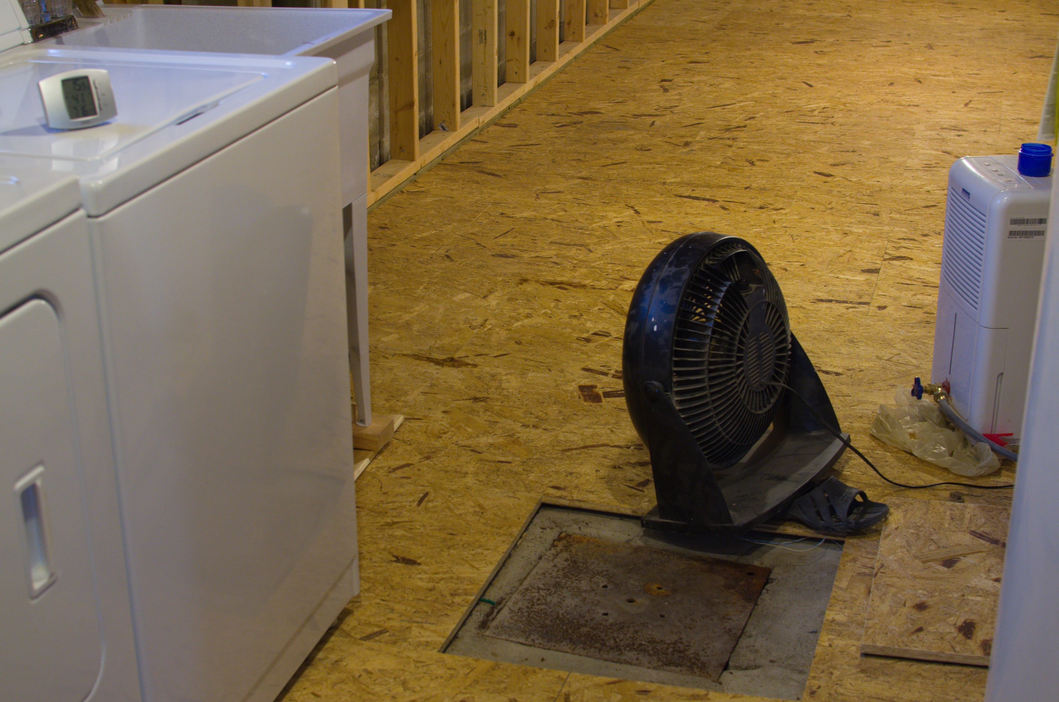

overall view of situation:
Eventually I need to build some kind of water tight containment area to put the washer, dryer and tub in.
I got lucky that the sump pit is just there so the water actually drained towards it.
Not the most optimal placement of dehumidifier but I'm limited by power outlet and drain. Also have to watch not to put fan too close to hot water heater heater air intake in case it back drafts.
