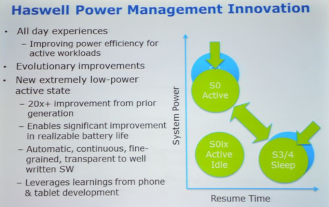

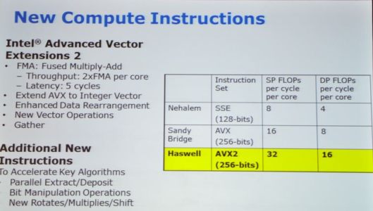

AVX was lacking and thusly it only lasted a couple years. AVX2 (haswell) was where things settled. Recently it was declared as the next dividing line for modern OSs x86-64-v3 (AVX2, FMA, MOVEB, bits).
Yes, the innovation list needs to be updated with what Haswell brought to the table.
Then Cannon Lake for bringing AVX-512.
When we crank on the AVX2 and AVX512, there is no stopping the Cannon Lake chip here. At a score of 4519, it beats a full 18-core Core i9-7980XE processor running in non-AVX mode which scores 4185. That's insane. Truly a big plus in Cannon Lake's favor.
That's two cores in AVX-512 mode beating 18 cores in non-AVX mode!
