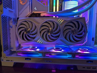

I ended up buying the EZDIY-FAB one. Is it ok to have the rubber pad of the support make contact with the heatsink fins of the GPU? Will the rubber pad melt on this GPU support if I do it this way? Is it better to place this device under the edge of the video card even if the fins of the heatsink or lower than the edge of the video card, meaning only the sharp edge is the only surface area that it would be resting on by doing it this way? What I'm basically asking is if heat transferred from the GPU to the heatsink can melt rubber if it's in contact with the heatsink?
In the pictures, the bracket isn't touching any heatsink fins so better to not do that. Just put it in contact with the edge of the graphics card shroud.
