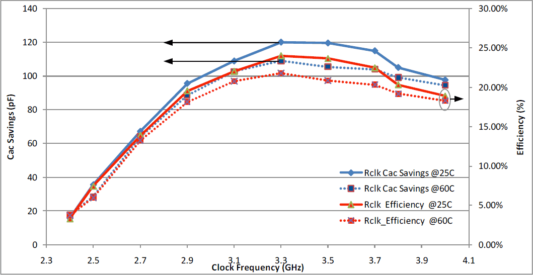

I doubt that since RCM is achieving its peak usefulness at lower clock range(between 2 and 3Ghz IIRC) and loses all the advantages when clock speed and voltage is pushed higher.
Prove me wrong, but to my understanding you can modify an RCM for different resonance peaks.
Abwx
Apr 2, 2011
12,004
4,967
That s correct , indeed.
The RCM interest is at the higher frequencies , the ones at wich
clock drive require a lot of current , hence increased losses.
At low frequencies it is more or less useless.
The circuit resonance is adjusted thanks to resistors
that will slightly shift the resonance frequency but also
reduce the circuit Q (selectivity and resonance factor/amplitude) ,
hence slightly reducing its efficency.

This is from a paper Cyclos submitted:
You can see where the drop off effect starts. It's possible it can be tuned additionally but whether AMD had done it to new FX or Richland is unknown.
