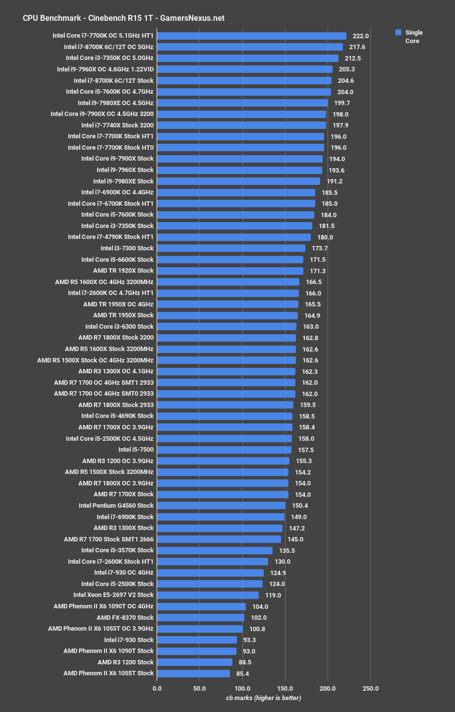

So, I'll say this one more time. This comes from Intel comparing coffeelake to Kaby. They showed about a 10% scaling over Kaby in ipc on a specific task. .
Keep digging that hole, by adding more errors to your argument.
There is no IPC improvement in CL, perhaps you just forgot the single thread clock speed boost improvement?
At locked clockspeed. KB vs CL perform the same. Check the top two performers:
https://www.gamersnexus.net/images/media/2017/CPUs/8700k/8700k-cinebench-1t-production.png
The top one is 2% faster, and is running at 2% higher clock speed.
So no change in IPC at all. IPC of CL = IPC of KL.

Fine, I meant "performance" not "IPC" and was using it as an example from an Intel slide. My overall point, though, is correct. Instead of digging critically on the measure, you are attacking superficial numbers from an Intel slide.
You overall point is wrong. For the third time 50% scaling from 50% cores is perfection, not poor performance. You made that incorrect claim, and compounded it by defending your position by equating clockspeed increase with an IPC improvement.
As far as AMDs small extra benefit from HT/SMT vs Intel, you need to realize, that how much room there is for SMT/HT improvement, depends on how good your front end is at efficiently utilizing your execution units.
The worse your front end is, the more idle time your execution units have, and the more room there is for HT/SMT to benefit.
So bragging about the SMT/HT boost, is bragging about how bad your front end is at utilizing your execution units. ;)
