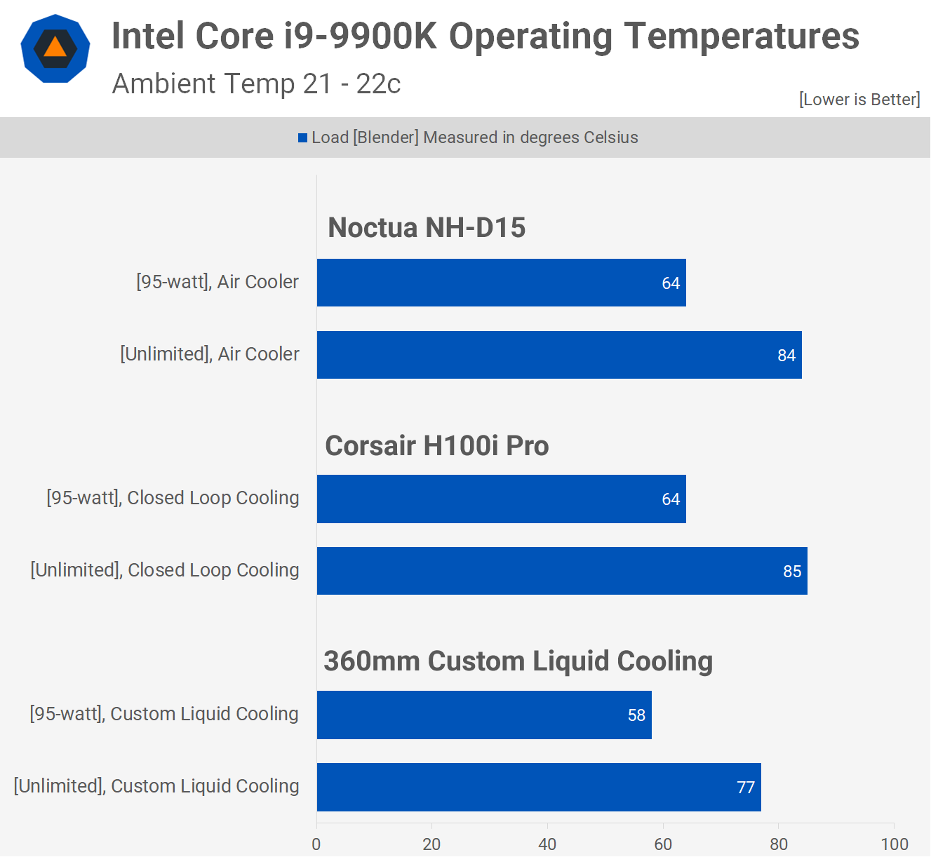

The 9900k is a very demanding CPU when not forced to stay within Intel's limit. Many motherboards have a tough time supplying the power for it, and if the motherboard has basic VRMs / chokes, they will run hot and throttle the CPUs performance. While the 9900k will run in older boards, many of the Z370 motherboards were not designed to properly handle the extra power. Heck, there are even entry-level and mid-range Z390 boards that struggle running the 9900k to its full potential.
I take it you must not have done much research on the 9900k before buying it?
https://www.techspot.com/review/1744-core-i9-9900k-round-two/
https://www.tomshardware.com/reviews/intel-core-i9-9900k-9th-gen-cpu,5847-13.html
And make no mistake, the Core i9-9900K requires expensive accommodations. You need a premium motherboard with robust power delivery, particularly if you plan on overclocking. The -9900K can drop into existing Z370 motherboards, but we’re sure that many of them will struggle with the chip’s voracious appetite for current. Also plan on investing in a high-end PSU.
You can see the remaining power consumption figures on the previous page, but under almost ideal conditions. The better the cooling, the better the power consumption. However, we were only able to record these large differences at package temperatures above 80°C, which then almost rise like an avalanche. This would dissuade us from air cooling, even if the Intel Core i9-9900K should not be overclocked any further. The 4.7 GHz all-core and a constant load are quite sufficient to make air cooling absurd.
