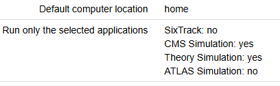

You can run VBox tasks like Atlas/CMS/Theory from Windows. Have you enabled them from the project preferences, besides just SixTrack?
Not as yet, but I may try, to verify working-ness.
