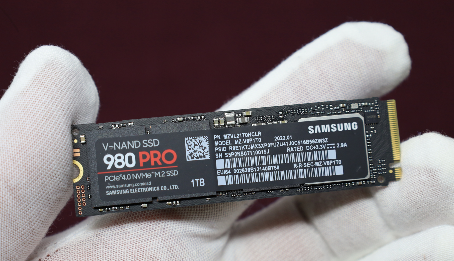

They reckon the idle temp for the 980 PRO is 36C. It'll be harder to find an accurate review of the 970 Evo Plus because it's undergone at least one revision.

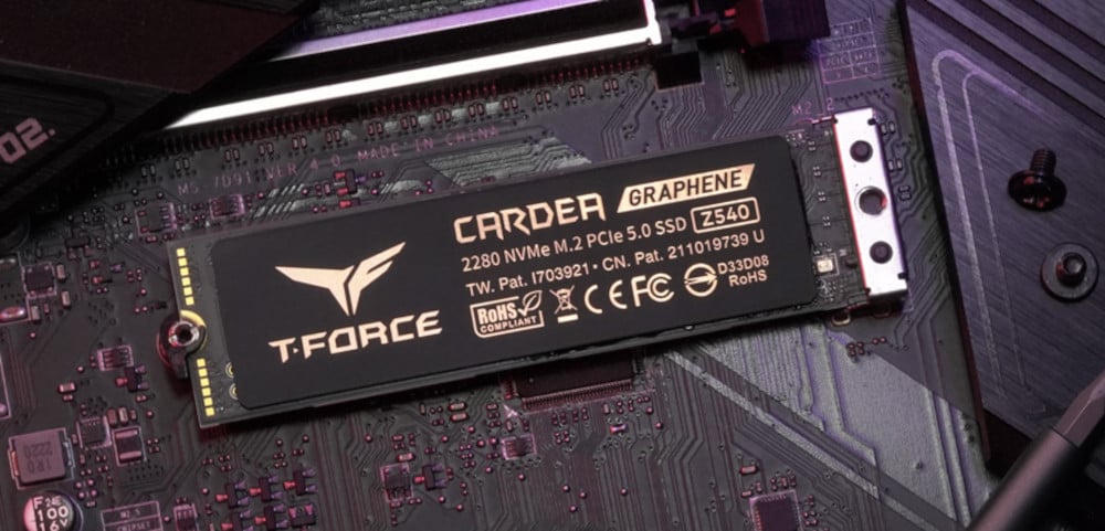

Not all drives it seems:
I fully expect that to throttle even with a mobo heatsink. Their own page says the graphene only improves temps by 3-5c.

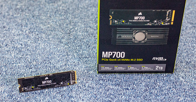

Corsair MP700 shuts down within 2 minutes reading or writing, needing a power cycle to restart it:
Crucial T700 throttles slower than an HDD:
These things are fraud perpetuated on customers. They must've known for years this is the direction things were going, but they continued anyway.
I mean what's the end-game here? Gen 7.0 requires liquid nitrogen?

@BFG10K
Is that really a valid basis for crying fraud? I doubt you'd be accusing AMD and Intel of fraud based on the benchmarks of their CPUs with the cooling system removed.
Don't get me wrong, I see that titchy little fan and think two things: 1) annoying whine and 2) dead far sooner than a larger fan.
I just think you're getting a bit carried away with your criticism.
Having said that, my main concern/belief is I'd bet that a significant percentage of the fans won't make it much past the 5-year warranty, probably zero will live ten years. I'd also bet that Corsair won't be stocking spare fans say ten years past the release date.
