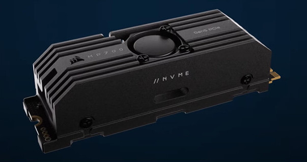

Gen5 NVMe have active cooling

To me it looks like a half-baked product using a reference design that was probably aimed at showcasing performance and sorely lacking power optimization.
Here's pics of the two products, try to tell them apart 🙂
Video of fan noise:
At this rate Gen6 will need CPU tower coolers and Gen7 will need watercooled Rads. We're heading in the wrong direction, folks.
Except it looks like Corsair's Gen5 will do the same.
