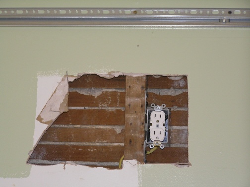

Outlets are mounted to studs. Find an outlet.
I may be totally off base, but I have it in my head that outlets are most often mounted to the right of the stud, as in the picture. Probably because most people are right handed.
