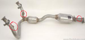

Actually, you have three O2 sensors; two upstream, or before the cat converter, sensors and one downstream, or after the cat converter.
This is a pic of your cat converter assembly......the two upstream and one downstream O2 sensor locations are circled in red.
We had a similar problem with a very similar vehicle as yours, a 2002 Blazer with the same engine....dropping gas mileage, engine began running a little hotter. Turns out the cat was clogged. Of course, our Blazer has about 5X the miles your S-10 has, but still something to investigate.
But bad O2 sensors will typically throw a code and light your CEL.
He is correct I was thinking of a 1/2 ton truck and not the S10 you have... Also yes you would normaly get a CEL with an O2 issue but possibly not with the MAF basicly being out of calibration due to the condition I stated...
