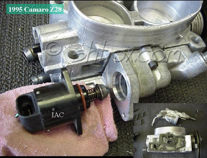

Best bet would be to get it to a mechanic who can actually diagnose problems honestly. Someone needs to read fuel trims and see whats going on.
In the meantime cleaning the MAF wouldn't be a bad idea, and is cheap. Just be sure to get cleaner specifically labeled safe for MAF's (aka electronic cleaner). Also, the 4.3L is actually a good motor, but does have it's little quirks. The IAC valve get's gunked up and tends to stick. I'd pull this (2 bolts) and clean it as well. It's mounted on the back of the thottle body.
Below is a pic to show what it is, it's a pic for a z28 but the whole throttle body assembly is pretty close to the same on the 4.3L. I'd get some sensor safe throttle body cleaner for this. You can use the MAF cleaner here, but it's a bit weak, but DO NOT use throttle body cleaner on the MAF.
