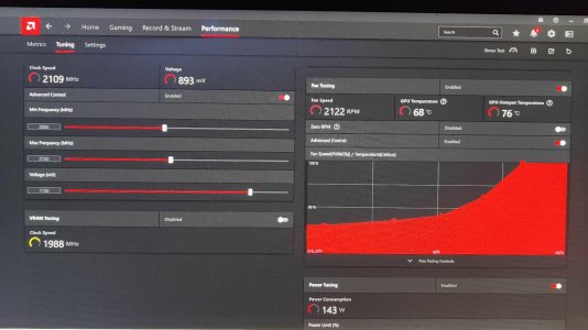

Question For poops and giggles I decided to check my GPU temps with AMD, and didnt like what I saw...
Shmee
Sep 13, 2008
8,268
3,154
From what it looks like, you are running your card with up to 15% extra power budget. That is going to make things warmer for sure, even if you do a slight undervolt. If I were you, I would run at standard power level, or maybe even a -% power level, as well as your undervolt. See how that works.
funboy6942
Nov 13, 2001
15,368
418
so far all the videos I have watched and read, say you have to run that high to achieve a stable undervolt, for the extra power is needed, BUT I will back it down and see.

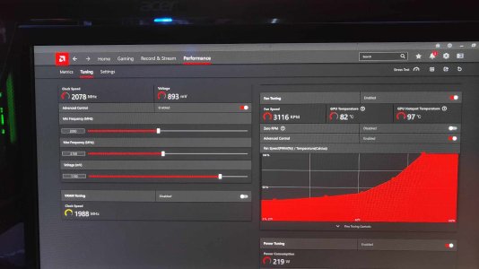

HOLLY FREAKIN HECK! I finally got it under 100c!!!!!! Dropped my mhz 100 points from each, dropped the voltage, bumped power back up 15%, and got this!
I'll TAKE IT :D and it only sucked 219 watts, like omg :p

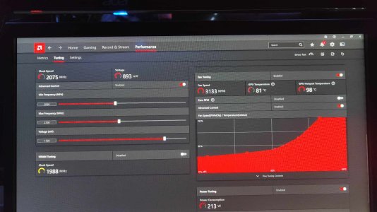

Now to test pinball and grid and see if it crashes, and if not, Ill post the new temps, if any.....

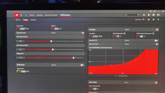

And here is GRiD 2019 at 1440p maxed out, no longer at 1080p Now:
All seeming to be stable, with no artifacts I can see, so yea me :)
