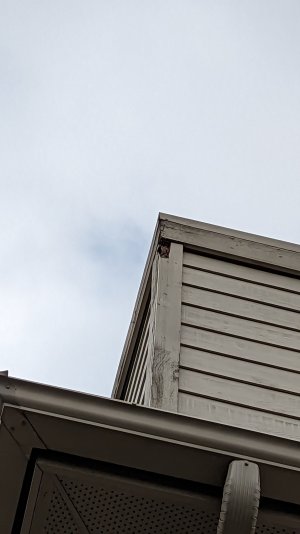

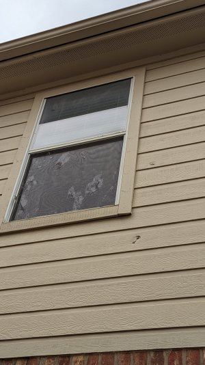

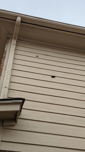

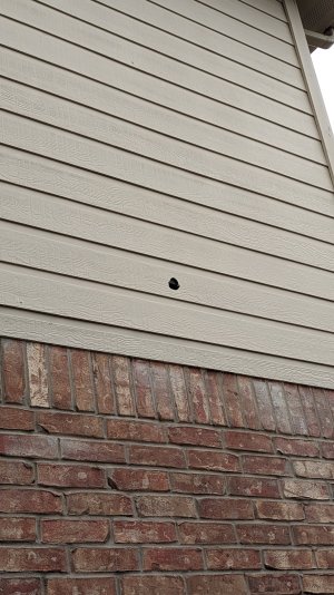

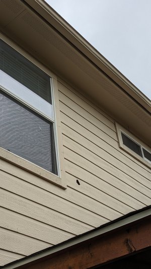

So a few weeks back we have experienced a freak hail storm in my area.
The hails ranged from the sizes of pin pong balls to softballs. My east facing side of the house have four to five holes, and the back of the house has one. The chimney also suffered a hit.
A company came and quoted me $4500 to replace the siding. They will also fix the chimney for another $4.5k. So a total of $9k!
Is that normally to cost this much?
chimney and the back
Personally, I'd be thinking about filler putty and paint for the siding. But I'm a cheapskate and I don't actually know if that's an effective solution for this kind of siding. The other issue might be, not the siding itself, but the location of some of these holes above pitched roofs - a dangerous place to work.

I don't know how big your house is...nor the complexity of the roof, but $15,000 isn't horrible for re-roofing a house. I had ours done about 2 years ago, with tax, one skylight, ($900) and slightly upgraded shingles ($300) the total was over $14,000....and our roof is relatively simple. AFAIK, the Hardie siding CAN be patched. It might not be quite as good as replacing it...and there's no easy way to check for any water damage under it, but it should be fairly easy to patch. There are specific patching materials made for the cement board...be sure to use one of those, not caulk or something like wood putty.,
The house is 2456 sq ft, two stories. The roof was actually replaced just less than two years ago for $16500 (insurance covered $13500 back then when I had dedutible of 1%) Most houses of similar sizes were between $15000 and $17000.
I have seen those patching materials but were told they are for patching small cracks, nail holes, anything smaller than 1 inch. Since the holes on my siding are two to five inches, patching wouldn't work right.
If it was me, I'd try patching the siding. It's already broken. You aren't gonna break it more. I'd have to contemplate it in person, but something like a wire backing epoxied to the back of the siding might make a good scaffold for patch material.

Patching the siding is possible, though a bit tricky. If the membrane behind the siding is intact, a small square can be cut out and patched in. The manufacturer won't accept it as a proper repair, but it can be done and should get you at least 5 years service. The trick will be finding someone to do it, no contractor wants the liability.
