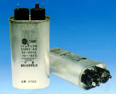

See anything in my pics that looked like the fuse or cap?
Originally posted by: Colt45
the fuse is in the yellow thing, it opens in half
don't see the cap though
Cap does not show in the pictures.
Memory thinks that it was about the size of a cig pack with an slight eliptical shape, but slightly taller. Usually mounted to the back wall with a couple of brackets
