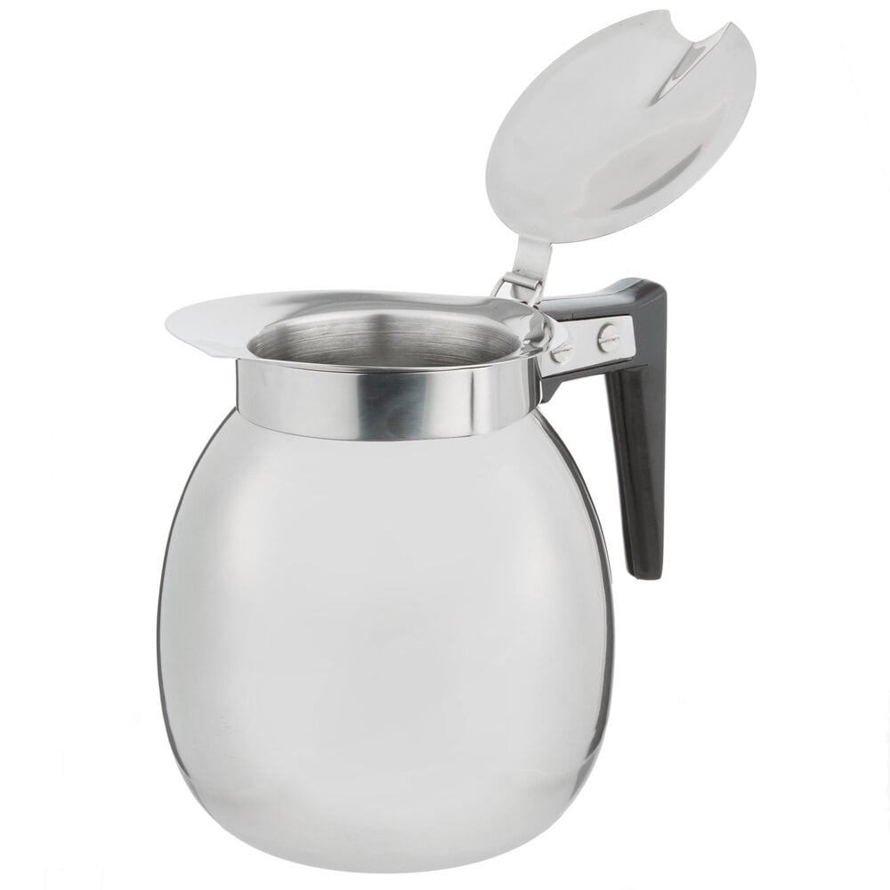

See pic below, I have an old style SS coffee decanter such as you saw in countless diners back in the day (1980's and prior). I use it to boil water, I hate what they sell nowadays with their whistles, complicated trigger mechanisms. I've used this thing probably close to two decades, but a few weeks ago I spotted a small pool of water under it after it sat for a while. Inspecting, I see a hairline crack around 3/4" long on the bottom. Inside there's some corrosion in spite of the fact that it's 18/8 Stainless Steel. I'm not worried about that, I doubt it's unhealthy to use (I mostly use it to boil water that I then pour in my SS coffee maker, but sometimes make tea or broth). I'd like to stop the leak. Of course, I could just use it anyway. I could empty it after use. The leak is minor, but I figure it will get worse.
So, thinking that this thing is beyond reasonable repair (is it???), I shopped online for a replacement. I spotted a couple of possibilities, one on ebay, a Brewmatic said to have a box not in great shape but a perfect item. It looked online like my old one (which doesn't say country of origin but does say Stainless Steel 18/8). The other possibility was sold new by a big company but it looks a little different and I was suspicious that it wouldn't be the same old time quality of something made in the 1980s. I went downtown to a restaurant supply warehouse (huge) that I used to go to but all they have now is the new kind, which are 1/2 plastic. I can't use that to boil water.
So, I buy the old "new" Brewmatic and get it yesterday and I'm hell of disappointed. It's a Korean knock off and crappy, probably made in the 1980's and stored on a shelf somewhere, maybe rejected/returned by someone. The steel is 60% as thick as my old one, it has a tiny dent and it has a few bruises on the sides (it was represented as brand new, perfect). I think I may return it, they want a possible 10% restocking fee and I have to pay return shipping, but I don't figure I'll love this thing like my old one. One drop and it will show nasty denting. Also, the cover is loose. My old one's cover is welded to the body but this "new" Brewmatic's cover is not welded, it's loose. I figure I can take it off and jam a metal shim in there and stop it from coming loose (it actually pulls off sometimes!!!), but maybe I should just bite the bullet and return it. I think I can probably get a free return from Ebay because it's not "new" ... has a dent, has bruises and the top isn't secure. What do you think? Pictured here is my old one, not the knock-off.
It might be hard to make a decent picture of the crack but imagine this: It's about 3/4 inch long apparently, meanders a little like a river and is extremely thin looking and is at the bottom near the edge. I figure it's potentially fixable but maybe only by virtue of a serious weld, followed by some machining/grinding/polishing. I have done propane and map gas soldering, never done any welding. Of course, I'd like to get into welding (as well as compressor DIY stuff), but have never made moves in those directions. Maybe there's another way, I figure some people here would know.

It's a 3/4" hairline crack. Spot welding/soldering and then grinding to a polish would be the best method.
Another cheap option would be to just fill it with some sort of epoxy/putty like this. Not sure how much heat it can withstand for the intended use.

JB weld is going to be recommended, however I'm not sure how I feel about epoxy (even steel reinforced epoxy) going through lots of heat cycles, and I'm fairly confident that JB weld isn't NSF or FDA evaluated, so using it on food/water items seems a bit sketchy.
EditEdit: I'll be damned, the above poster has a picture of it and it says NSF safe, carry on!
Lead, lol. It might be worthwhile to take it to a competent welder. It probably won't be cheap, but stuff like that is worth preserving, imo. A welder could probably TIG that up pretty easily, though it might cost close to $100 to do, since there are minimums involved in setup, etc., and the inside of the kettle has to be back purged with inert gas during the process to prevent "sugaring."
JB Weld... hmm. Thing is I've boiled that sucker dry a number of times (by accident, of course). That's probably the reason that crack presented anyway. If that happens again (likely will/would), I have to think the JB Weld fix, or even maybe that micro torch repair, wouldn't hold up. Dang. I really am thinking I should return that cheapo Korean knock-off, I just won't be happy with it, even after jury-rigging the dang lid to stay put. It's gonna look as crappy as it really is in not long.
I think I may just keep on using my leaky boiler until I can find another rare bird (a for-real old time decanter like the one I posted a picture of in the OP). If I only leave 3 oz. or so of water in it it doesn't leak at all, at least it didn't last night. If I leave 16 oz of water, then it will leak, least that's what it has done the last 10 days or so. But that leak is apt to get worse. I'll keep my eyes open for a for-real replacement...

Find a competent TIG welder and he will have that fixed up in 10 mins. Probably still charge you for a hour though, expect to pay $80-120.

In order to fix the crack properly and make sure it does not leak you will have to put the lead solder on the inside surface.

Could probably solder it, use plumbing solder. Though proper way is probably to weld it. Not sure how well solder will stick to stainless or if it will react weirdly etc. Worth a shot though.
A few thoughts...
That pot isn't worth the time it takes to fix unless you simply want to learn a new skill. I think braising would be the proper technique.
The new pot... It was ≤$20? Screwing with returns would cost me more in time than it's worth. I'd fix it up as well as possible, and use it til I found what I really wanted.
