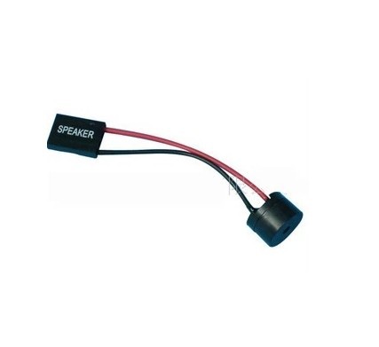

I tried booting up the system OUTSIDE but it goes on for about 3 seconds then it shuts off. I'm not sure if the motherboard has a built in speaker, but I hear no beeps.

I don't know if there is a speaker built into the motherboard, the manual says nothing about it. There is no LCD display with POST codes, like my old board with the dreaded FF display. There is a red light that turns on when the board fan and PSU start to run, then everything shuts off.

When it "boots" the fan picks up then it dies down and is quiet but it is spinning. There doesn't seem to be any sort of speaker on it and the case does not have on either. There are no speakers built onto the board or the case.

Same thing happens in the case. I was able to hook up a small speaker I had laying around. Looked up a AMI BIOS beep codes, but I am not sure what is considered a long and a short beep. Seems like long beeps I can get up to 4ish(4,5,6) before it shuts off on me.
