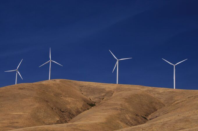

What is the worst consequence from a wind turbine failing? What the worst consequence from a nuclear power plant failing? How many orders of magnitude more operating hours do wind/solar have than nuclear? Do you disagree that things that have a higher consequence of failure should have a lower probability of failure? In commercial aviation, a failure that would prevent continued safe flight and landing should occur less than once in a billion flight hours. What rate is acceptable for potentially contaminating a major watershed/hundreds of square miles? Or just the billions of dollars in clean up like at TMI?

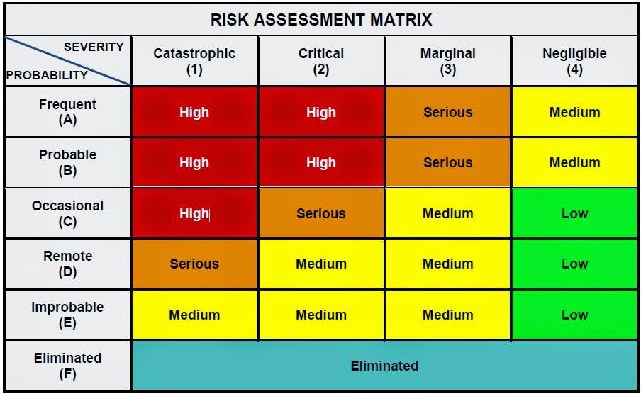

As reference, remembering "catastropic" generally means a death or loss of vehicle not a meltdown:
That is a cursed risk matrix and I recoil looking at it.
Catastrophic very high likelihood, (5x5), should be upper right and hazards are never eliminated only controlled to very low probability.
If a hazard is deemed “eliminated” then it’s non credible and doesn’t need an included risk matrix or hazard report.
(IE if the risk is death from from a burst tank but you remove the tank from the design then the risk is “eliminated” or non credible and it no longer needs to be included in hazard report or risk matrix)
now I’ll read the rest of your post.
Yeah, that is the one from Mil-STD-882E. I don't love it either. You are correct on eliminated, I think it is on the 882 matrix so if you eliminate a risk from the design you have the terminology to explain it. It also provides a training opportunity that no possible hazard can be eliminated.
