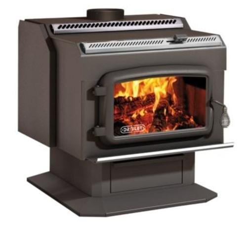

Have you considered a wood stove????
http://www.amazon.com/Drolet-High-Efficiency-Wood-Stove-HT2000/dp/B000A6D196?tag=finest-fires-20
