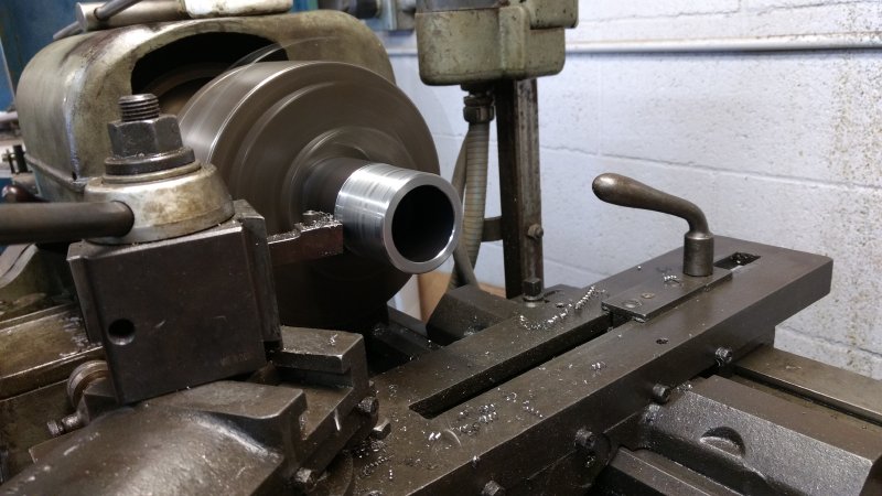

I asked my dear friend to put the new bushings' metal sleeve in the lathe and machine the diameter to a little smaller so I may press the metal sleeve into my subframe.

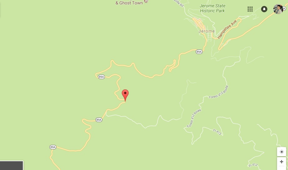

When I posted this on Insight forum, there was someone voiced their concern about the new bushings would make the car more prone to oversteering. I drove the car for a month, even took it to highway 89, and I didn't notice any. Lane change and corner is actually now more precise than before.
