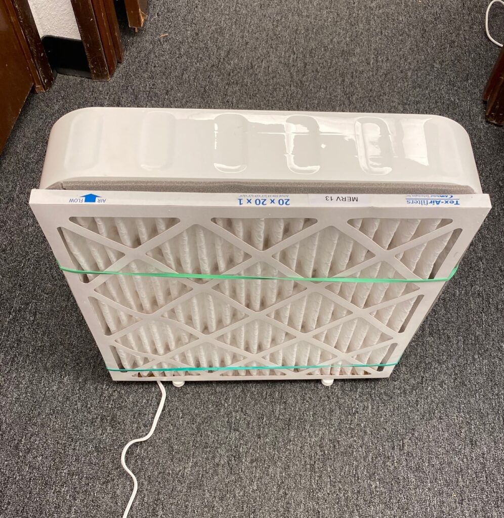

Put 20x20 filter on 20inch box fan with extra large rubber bands.
Have box fan up close to PC and pointed at it.
This will force induct clean air into your PC.
You will still get some dust, but not that much, as the filter on the box fan will catch 90% of the dust your PC would of caught.
It should look something like this:
Its a far easier and cleaner solution on catching the dust b4 it gets to your PC then catching the dust on the PC.
Its also a lot healthier for you as your catching the dust you could be breathing in as well.

Interesting, but I don't really want to to run a box fan in my office to filter the air for my PC. Now for a server room, I really like this idea.
^ Nor does anyone else. 😉
