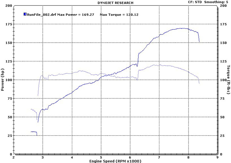

Fiesta 1.0 Ecoboost Dyno
torque line, rather than curve. that thing's flat.
Generally flat torque curves on little turbo motors mean that the power has been tuned down to keep it from being peaky.
Meaning there's likely a fair amount more on the table. 😀

The Elise has more power, less torque, and is more peaky:

That is an M plate car. That means it's a test mule for Ford. It may or may not be modified from stock. I wouldn't trust a dyno from one, that is for sure. The exhaust is not what will come from the factory, from the looks of it.

This should be a lesson that peak hp/tq numbers mean very little. If it spikes to 200hp for a 100 rpm band it will be slower than the same car with a motor producing 125 hp over a 9000rpm curve.
I'm a Honda fan but there's weird stuff being said here. On the dyno there's not a single RPM where the Fit makes close to the same power. I can't explain the acceleration, maybe it's gearing? Or maybe the curve is just a lot more usable in the 1.0 and doesn't require downshifting every time you step on it etc - but I haven't driven a 1.0 or the 2015 Fit. I bet for motoring around town the turbo 1.0 would be a lot more zippy given the torque advantage.
EDIT - I tried to superimpose some dynos but need a 2015 dyno graph and removed it.
Also the Fiesta gets quite a bit better mileage from those I've seen. As for reliability and "Stressing" the engine, is there really any evidence showing these 1.0s are that unreliable? From what I read this is a fantastic engine, but again, I haven't test driven one yet... Also it's been given many awards like "International engine of the year" for 3 years now.
There's one reason I posted this up - it's to share that small turbo engines are back (or "here" in the USA finally) and aren't going away any time soon. I'd be shocked if most companies (even Honda) don't take inspiration from all the great examples out there now. F1, Le Mans, and most European cars have had turbos for years. The fat torque curve on this Fiesta would make it a lot more fun to drive than the Fit IMO. I drive a 1.6L Turbo Fiesta ST... My girlfriend drives a 2009 Fit, but I haven't tried the new ones. I still own two VTEC powered Hondas 🙂
