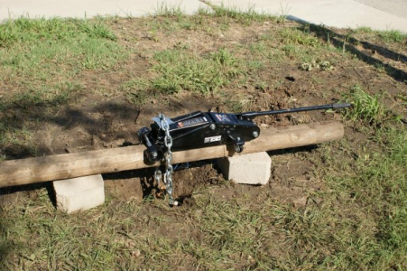

Here is a contraption I used to pull the part that was buried...I drilled some holes in the post stump, stuck some rebar through it and then put the floor jack over it, attach a chain to rebar and the stump came out easily LOL...1757442253275.png
if you replace them, I would use metal poles...and then replace the other wooden ones as they rot out...
Here is a contraption I used to pull the part that was buried...I drilled some holes in the post stump, stuck some rebar through it and then put the floor jack over it, attach a chain to rebar and the stump came out easily LOL...View attachment 129901
All i can say is.. wow! 👍
