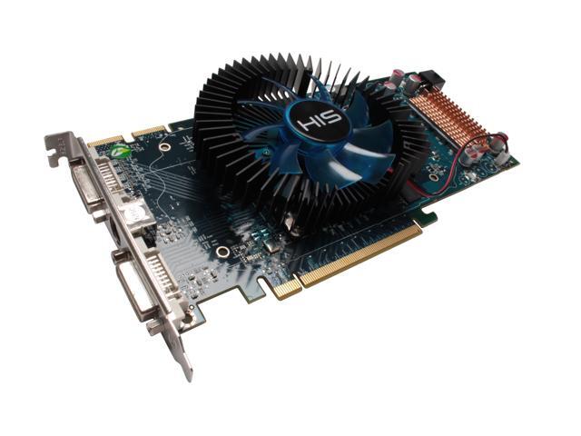

I just had my computer shut down in the middle of the Witcher 2, which is pretty intense, performance-wise. I popped open the case, blew the dust out, and started it back up. According to GPU-Z, the fan speed is 100%. However, the fan wasn't spinning. It was idling at around 80 degrees C at my desktop. I turned everything off, blew everything off again, reseated the video card, checked all connectors, and turned everything back on. This time, it's idling at 60 degrees C and rising, with the fan speed at ~40 %, where the fan is actually turning ever so slowly (3-5 seconds per rotation, if I had to guess). As far as I can tell, the card is still fine and unfried.
The card is an HIS ATI 4850 paired with an Athlon II x4 635. Pics of card (I hope it works): http://images10.newegg.com/NeweggImage/productimage/14-161-259-03.jpg

Can I fix the fan? I've seen suggestions that say to try oiling the bearings, but I'm not sure what kind of oil or exactly how to access the bearings.
If the fan isn't fixable, how easy/inexpensive is it to replace the fan? I can afford to buy a new card if I need to, but wasn't planning an upgrade until early next year, probably.
Fan recommendations? I've never replaced a GPU fan before. Note, I accidentally snapped the little lever retention thingy on the motherboard off, which might make the card less stable for heavier fans.
Should I just buy a new card at this point?

Well, a little bit of lube on the fan and I seem to be back in business. It's actually spinning now, and idling at about ~45 C. I'll keep an eye on it though.

Relubed it tonight with grease instead of oil, and I'll continue to monitor. It's working thus far.
Grease won't help anything much. For your application, light oil is all you need.
You could remove the existing fansink, pull the existing, failing fan, zip tie an 80mm case fan to the sink, connect the fan to a motherboard header, (if possible) configure the header in BIOS to slow down the fan and cut down on noise.

Refurbishing that dead fan isn't going to happen. And spending more than 10-15$ on that card would be a bit of a shame, given how much new, better cards are going for.

I'm thinking about it. Pull the current fan, go grab a 120mm case fan from somewhere, add zipties, and presto. I've also contacted HIS to see if I could just get a replacement fan. I just want to last until early next year, when hopefully the new cards will be out.
