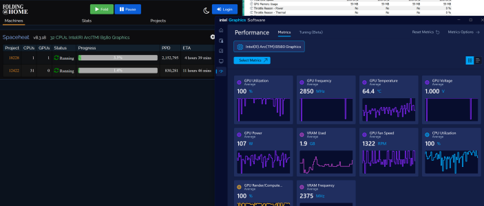

Just added an Intel ARC B580 to the mix.
Epyc 4564P (16c/32t 7950X equivalent) + Intel ARC B580 12GB GPU. It ain't much compared to my 4080 Super, but it's something :)
