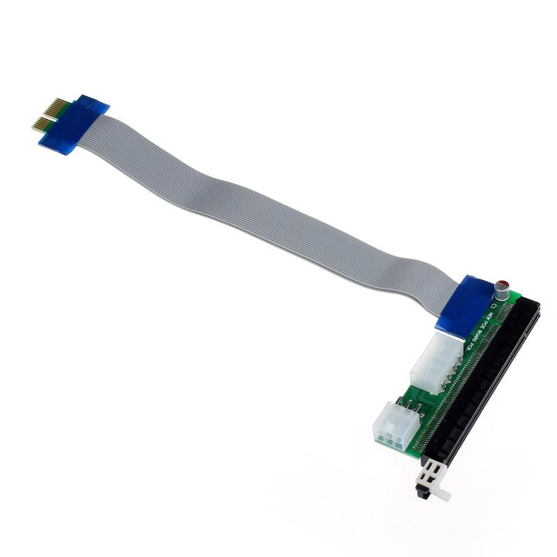

For risers, I have a bunch of these and they've been good to me.
The nice thing with these is if you don't have enough peripheral cables laying around, you can run a two ended PCIe power cable to the 6 pin of two adjacent cards, and another dual end PCI cable to the powered riser. That way it only takes two PCIe cables to power the risers and 6 pins on two 480s.
Those risers look great. A quick search on eBay brings nothing up though. Do you mind sharing where you got them from?

Mr. Teal - still wondering if you can link us to those risers from yesterday that had the 6pin pcie power plug?
For what it's worth Bitcoinware.net in Toronto has risers in stock @ $13
Yes I've ordered dozens of risers from them. However yesterday eBay had a $20 off $75.00 coupon. I ended up ordering the identical risers from eBay. Sure they'll take a month to get here but it only cost me $73.00 in total for 12 risers 😀
