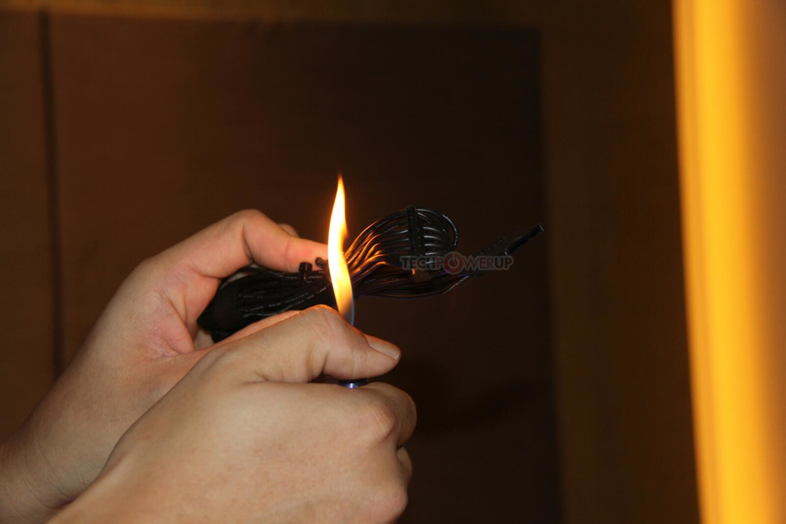

What we need is this:
"XIGMATEK showed off an interesting innovation for those pyrophobics among you. The company innovated fire-proof PSU cables that, in practice, minimize the chance of an overloaded cable heating up enough to melt the cable-insulation, shorting up, and starting a fire. If the insulation can stand fire from a lighter, it can withstand a heated cable. Most modern PSUs do feature overload protection that turns the PSU off in case a cable is overloaded."
http://www.techpowerup.com/223212/xigmatek-shows-off-fire-proof-psu-cables
