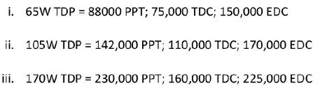

"Eco mode" is nothing special. It's just a convenience "one click" button for setting 3 PBO values. You should still be able to set the same settings manually via PBO (pictures in the article):
PBO has 3 settings:
  • PPT (Package Power in Watts),
  • TDC (Thermal Design Current in Amps)
  • EDC (Electrical Design Current in Amps)
For AM5 these seem to be entered in mW and mA (thus the 1000x bigger scale than AM4)
Setting these values is the same as setting 65W, 105W, 170W "Eco mode":
How to set them varies somewhat depending on the MoBo maker but essentially it boils down to:
  1. Find the "Advanced Overclocking" menu, click "Accept"
  2. Find PBO settings and set them to "Advanced" / find "PBO Limits land set to "Manual"
  3. For 65W set:
    • PPT - 88 000 mW
    • TDC - 75 000 mA
    • EDC - 150 000 mA
  4. For 45W It's a bit more complicated as AMD doesn't give exact values )Perhaps one could find the exact numbers when setting "eco mode" it in Ryzen Master?) but interpolating the 65W and 105W ones (from this post) it should be around:
    • PPT - 61 000 mW (this number is straight 1.35x "TDP on the box" and rounded)
    • TDC - 59 000 mA
    • EDC - 130 000 mA
    • Bear in mind, these are my approximations (extrapolated from here).
  5. Double check you entered everything correctly (also read the article and take a look at the screenshots)
  6. Save and reboot
  7. Happy "Eco Mode" usage usage :)
NB! these values are only for AM5 mobos / CPUs. AM4 values are different (legendary "the Stilt" has them listed here).
Also bare in mind that for 12-16 core parts the 105W values probably are a better sweetspot (that's their one-click configured ECO mode as well)
TL;DR:
There is no offical 45W "Eco mod" form AMD as it only seems to go down to 65W. But extrapolating the actual PBO values (which is the only thing "eco mode" actually changes) The 45W numbers shoud be around PPT: 61W, TDC: 59A EDC: 130A. Feel free to try out different values nearby that work for you.

Sorry for editing the post, last minute. I'll condense the relevant parts out again:
There is no offical 45W "Eco mode" form AMD as it only seems to go down to 65W. But extrapolating the actual PBO values (which is the only thing "eco mode" actually changes) The 45W numbers shoud be around PPT: 61W, TDC: 59A EDC: 130A. Feel free to try out different values nearby that work for you.
So the 45W starting-point settings should be around:
  • PPT - 61 000 mW (this is fixed as the number is straight 1.35x "the desired TDP on the box". This is also the actual wattage you'll see in HWinfo at 100% load. The 65W AMD CPUs tend to take ~88W at full load for instance)
  • TDC - 59 000 mA
  • EDC - 130 000 mA
Thus. The PPT should be 60-61W (depens how you round) for "45W TDP". TDC can be raised if temps are low and performance suffers (e.g. your cooler can handle more). EDC tends to be the limit for short-term single core boost. if the ST turbo frequencies are hit too hard this is the setting to raise (It would be smart to keep all of these well below the 65W values, if you want to benefit from the "45W eco mode" though)

@Gideon As far as I understand, the difference between ECO / PPT-TDC-EDC on one side and Curve Optimizer on the other, is that the former is supposed to be validated by AMD, but the latter falls to the customer to verify stability, doesn't it?
That's correct. "Eco Mode" probably is covered/validated by mobo manufacturers and AMD. Undervolting most certainly isn't.
I'm not 100% sure about even manually setting the 3 values. (as there.is the same "Accept Potential Damage" dialog). It should be fine, as you'll be setting them stricter than is standard, but that's not guaranteed.
Unfortunately there is no out of the box 45W ECO Mode forAM5 (while there was indeed one for AM4)
If there is, it should be easily validated by running Ryzen Master. If it exists, you should be able to select it here , but AFAIK there is nothing below 65W for AM5 (Someone with a 65W AM5 processor should validate that claim). If there is, the PPT-TDC-EDC values set by Ryzen Master should be easy to find.
