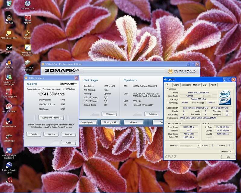

Tonight I pushed the envelope a litle further.
I manage to 12.941 at 3dmark2006, using a 695x1055 and 3,6 and 900 mhz 4.4.4.12.
3DMark Score 12941 3DMarks
SM 2.0 Score 5771 Marks
SM 3.0 Score 5795 Marks
CPU Score 3246 Marks
I think I could go even further but didnt have enough time.
By de way ambient temp was about 18C, and it was real nice.
Lower temps make all the diference.
3dmark06 - 12941

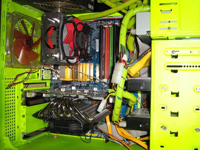

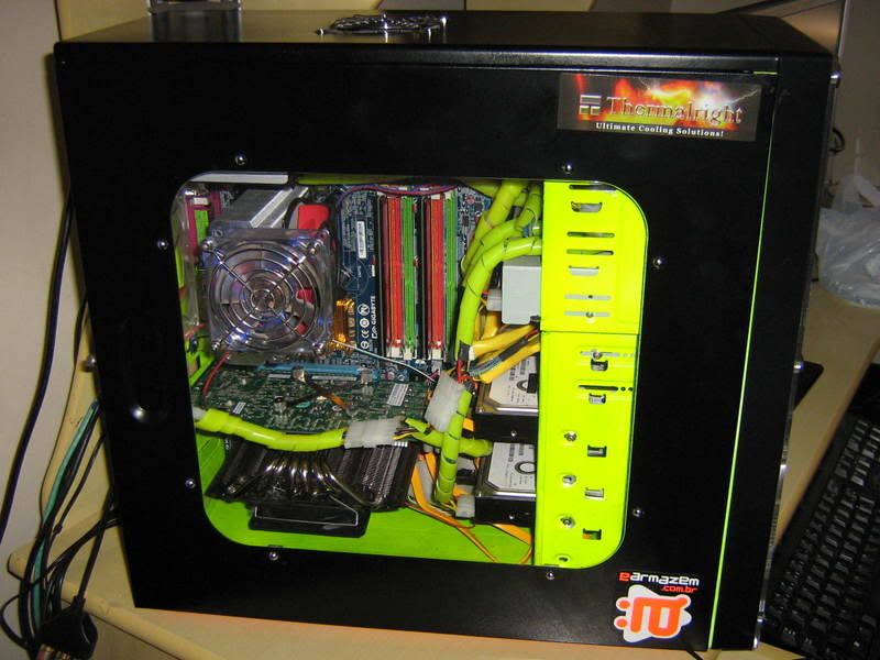

Some screens of my custom case.
baby
baby 2

Nice score! You still beat me even when my vid card was overclocked more. You should try to break the 13k mark.
Did you buy your 3dmark2006 pro? I'm just using the freeware version. I wonder if there is a difference. There shouldn't be.
When you are running the benchmark what do you turn off or disable? I noticed before you turned of explorer.exe. Anything else?
I see from your sig that it takes you quite a bit more juice to get to 3.6. Did you test for stablilty for 24/7 3.6?

I'm using 3dmark2006 pro. I updated to F6 Bios, and 169.04 Nvidia drivers.
I don't think there is any difference, just to make shure I tryed with 3dmark freeware and the only difference is you get your marks on internet.
I turned off antivirus, firewall and explorer.
My system runs 3.6 stable at 1,504 V, and nothing less.
I was worried about that, so Im not using 3.6 24/7.
I don't think I could pass 13k, but I'll try.
I didn't push the memories to the limit, I gues I could go close to 1100.
I'll try push GPU to 700 first, and then push memories.
I takes a lot of time, and I'm looking for another cold day to try it.

Here's a screen shot of CoreTemp and CPU-Z showing my E-6750 with the Tjunction as 85°C. ( www.wpcoe.com/e6750.gif ) Does yours show "Core Temp 0.95" both in the title bar and from Help > About? I expected it to say "Core Temp 0.95.4."
Based on those two oddities I'm paraniod thinking something is wonky with either my processor or the mobo.
I just now noticed in that screenshot that CPU-Z reports the Core Voltage as 1.296V, even though I have it set manually to 1.35v in BIOS ( all other voltages set to "Normal".) I had opened a large file in Photoshop and applied the Lens Correction filter to get the processor to show 3.0Ghz rather than the 2.250Ghz it shows at idle since I have EIST enabled now.
When the CPU is at idle, like right now when I only have a broswer open to write this message, the Core Voltage varies between 1.296V and 1.312V. I thought that the voltage would not vary with EIST when the processor is overclocked, only with a change-of-state to Standby with C1E enabled?
-- Bill @ getting more confused...

You should see Core Temp 0.95.4 in the title bar. Download here Make sure you grab the Beta version.
The motherboard is somehow 'losing' (to heat probably) the voltage and it is dropping from the BIOS setting of 1.35V. This is Vdrop. When you run an intensive program the voltage to the cpu will be even more scarce, which to my understanding is Vdroop. Droop because it looks like a sag on the Vcore graph, is how I remember it, and it sort of just drops during booting never to bounce back. Of course, EIST and C1E complicate the Vdroop graph.
As I said earlier I found I could go up to 3.2 GHz OC on normal voltage and experience just what you are seeing. I was getting it to work with manual voltages with everything set to normal in BIOS. The volts were jumping from 1.35 to 1.16 or so as it went from 8x to 6x.
I think Conjugal's nice VID is so low he drops to under 1.00V on 6x multi. But I personally didn't see any effect in C1E and EIST going from F2 to F4 or F5.
