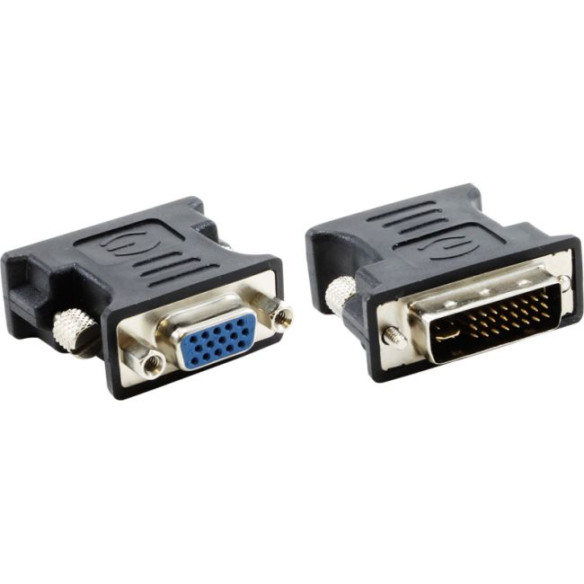

It will always output as analog since VGA uses an analog signal. As for how it is handled, that depends on what you're doing. If you're using an actual DVI-to-VGA (digital to analog) converter, it may have some impacts upon quality, but I doubt they'd be substantial. If you're using one of the adapters that they used to throw in the box with video cards (like this one), then there's no conversion. On a DVI port, you'll see that there's something that looks like a giant plus sign '+'. If the DVI port is analog-capable, it should have a pin in each quadrant of that plus sign. However, most cards have been moving away from being analog capable. You can see an example of the different connectors here.
