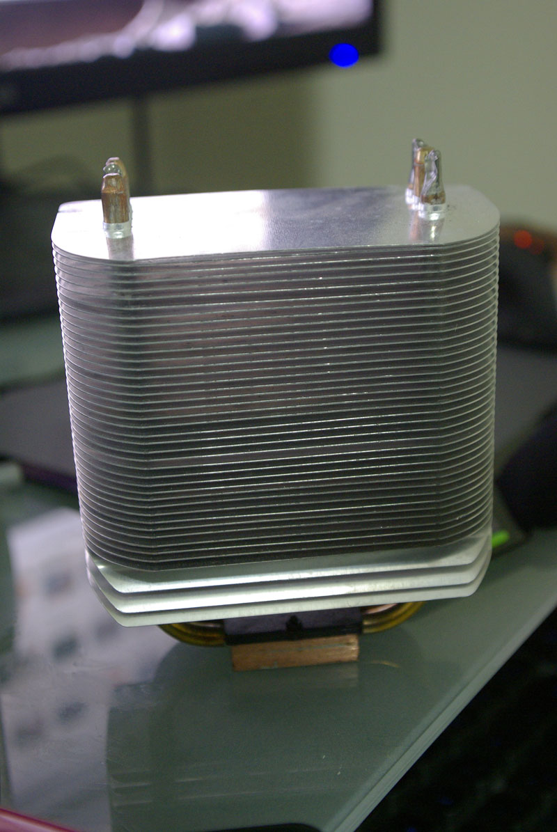

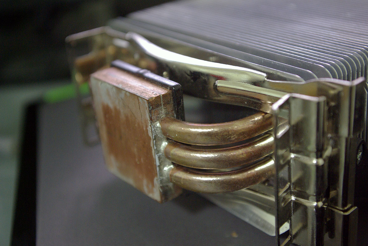

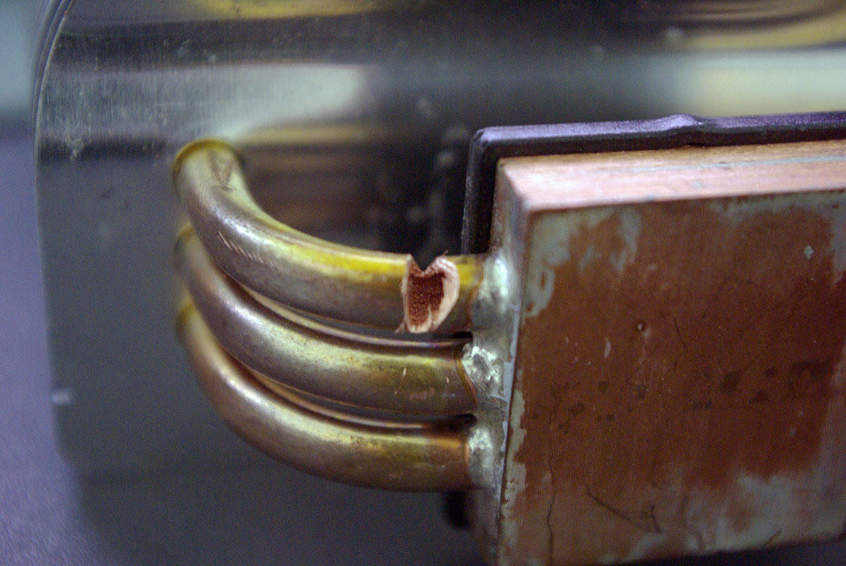

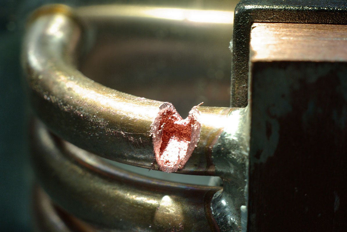

Also, I decided to get a little firsthand information on this, since I had trouble finding anyone who had actually opened up a heatpipe on a shipping heatsink:
Started with an old Artic Cooling Freezer64 I had around:
For those who missed this gem, there's 6 heatpipes that run out the base, though I really only needed one:
As it was 1:30AM, the dremel probably would have annoyed the neighbors a little. Hacked a hole into the side with a file instead, and blasted it pretty good at point blank range with canned air:
Little hard to see there, here's a closer look with better lighting. That's not dust from cutting in there, the whole thing has a sintered metal lining. In this case, this is what's being used as a return path for the fluid. You'll also notice there's nothing dripping out of it - you don't need very much fluid at all (I wouldn't expect to see free liquid, just enough to wet both ends, which is why you don't hear sloshing in heatsinks), and between age and having being opened to the atmosphere and repressurised, there's none to see. Either they're very convincing and rather expensive fake heatpipes, or Artic Cooling was using the real deal in a $40 heatsink 5 years ago.
Either there's a massive conspiracy to make everyone think they have heatpipes in their PCs, or the real thing has become quite common.
Looking at the photos, you can also see how the heatpipes allow heat to be fairly evenly distributed and disapted over a substantially larger area than would have been possible otherwise (and this is actually quite a small heatsink by todays standards).
One thing this doesn't really show off (but the FAQ linked above explains) is how heatpipes allow the fins and fan to be removed some distance from the heatsouce - you see this a lot in laptops. Since the primary method of heat transport is by fluid and not direct thermal conductivity, the effective thermal conductivity gets higher just about in proportion to length, as the thermal gradiant stays pretty close to the same.

2. http://www.frostytech.com/articleview.cfm?articleID=2616. Cuts open a Zalman "heat pipe" cooler. Note there is no liquid inside.
So, in conclusion, there is a lot of confusion surrounding the term "heat pipe" in both the enthusiast and aftermarket community. CPU coolers are called "heat pipes," but they do not contain the components of a true "two-phase change heat pipe." What they are in fact are heatsinks, which may be "pipe-shaped," or even hollow. But they are certainly not phase change, and rely on thermal conductivity instead.
Further reading on phase change cooling, the concept and implementation: http://www.overclockers.com/build-your-own-phase-change-pc-cooling-system/

the contents inside a heat pipe are subjected to pressure.
This is why heat pipes are sealed.
The moment u cut open a heat pipe, that pressure is brought to 1ATM standard.
At that pressure the liquid is converted into Gas.
No one will use a liquid which stays liquid at 1atm because those liquids arent as efficient as the ones which are used inside heat pipes.
As pressure increases, a gas will turn to liquid, and u can get your "heat pipe" action working.
Your all under the assumption that the liquid inside the heat pipe stays liquid at standard pressure, when it doesnt. It only stays in liquid form as long as its subjected to pressure inside a sealed heat pipe.
And well, the moment u cut open one, yes, your not going to see liquid because that liquid no longer has the pressure to stay liquid and will escape as gas.

Air wouldn't work very well, for a couple reasons. The efficency of heatpipes comes largely from the working fluid changing state, and regular air is bad for that in a couple ways. First, it's not going to be a liquid at the sorts of temerature we're interested in, so state change isn't going to happen. Second, air is a mix of gasses, so you don't get a single boiling point to design around - you'd have situations where the less volatile components are lying around taking up space, interfering with the ones that are actually working.
If you wanted to run a cryo-temperture heatpipe, though, you'd probably use something that's a gas at STP. Nitrogen and argon are both cheap and fairly nonreactive, so I'd expect they're likely candidates.
As to vacuum charging - take a closer look at the photos of that Freezer64 I posted. Notice how each heatpipe (there's three, really, bent into U shapes) has a machined copper end and a crimped-and-metal-coated end? It's most visible for the front set because of how I took the photo, but you can see it on all of them. I'll give you three guess why that is. Hint: it's not a stylistic choice.
Again, either manufactures across the board are putting in needlessly complicated fake heatpipes that have everything but a working fluid in them and claiming they're the real deal, or they're using real heatpipes. If you believe the former, I'd look into turning those aluminum fins into a nice hat.
As well, to repeat another point that wasn't addressed - solid copper rods would (and do!) transfer heat than hollow copper tubes (not heatpipes) - cross sectional area is key. Do you really think there wouldn't be someone using that for market differentiation? Or someone selling actual heatpipe based designs, for the same reason?
As an interesting bit of an aside, you can see the effect aigomorla is talking about in reverse sometimes when you open a bottle of warm pop, and a bunch of condensation appears in the air in the bottle. It's quite a noticable change, even though the pressure drop isn't actually too great.
