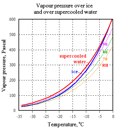

Not only does water have a vapor pressure below the boiling point, like several people mentioned earlier. Even below the melting point (0°C) water has a vapor pressure. *mind blown* Although compared to atmospheric pressure (~100 000 Pascal) it may not be enough to transport heat efficiently or in high capacity.
Boiling "point" is a rather meaningless little equilibrium between vapor pressure and atmospheric pressure, it's completely misconstrued as a fundamental material constant at which liquid suddenly explodes into gas. Even though every one of us hangs socks out to dry without heating them to the boiling point, even during the winter in Alaska and Siberia people do this.
My guess is: The problem with cold temperatures is that they effectively block the wick, water will still evaporate but it will collect at the cool end of the pipe as ice, causing the heatpipe wick at the hot end to run dry. Ice crystallization could also break the wick structure.
