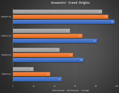

Games see a significant difference.
Personally, I wouldn't recommend anyone run single channel RAM because that's like running a car in first gear. Sooner or later the CPU will get starved for data from main memory.
TIL. Most of my games are… older.
