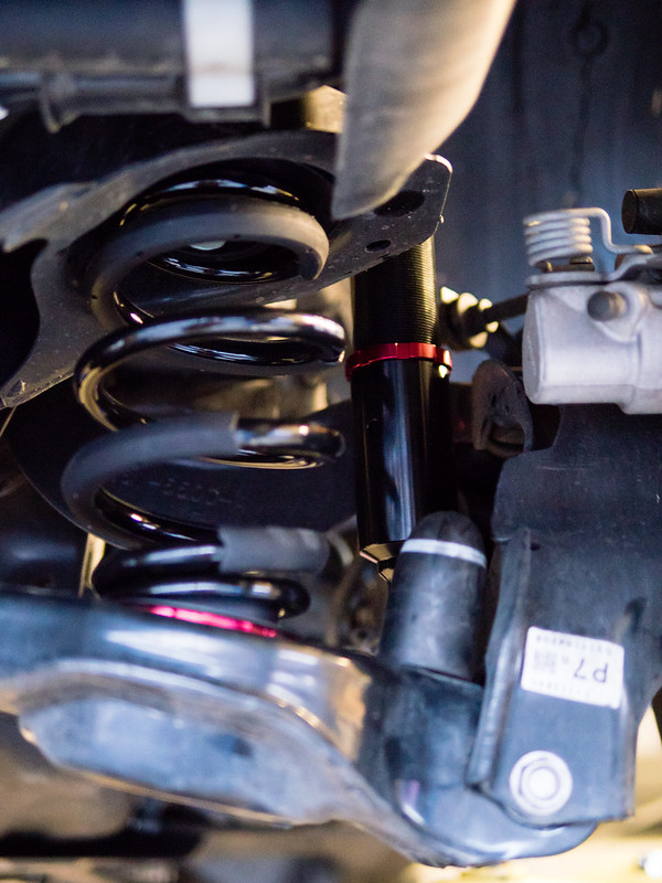

Some shots of the rear struts and springs
P1120167 by tuanies, on Flickr
P1120169 by tuanies, on Flickr
P1120176 by tuanies, on Flickr

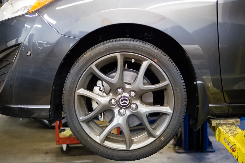

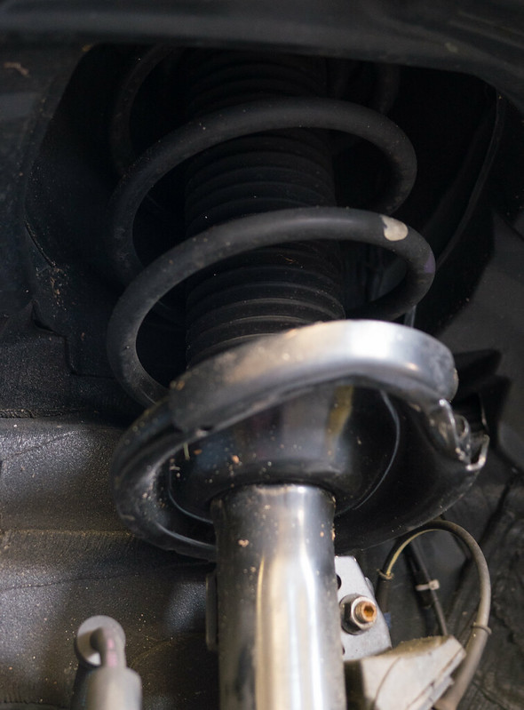

Let's start with the front. Check out how much travel there is with the stock setup.
P1120179 by tuanies, on Flickr

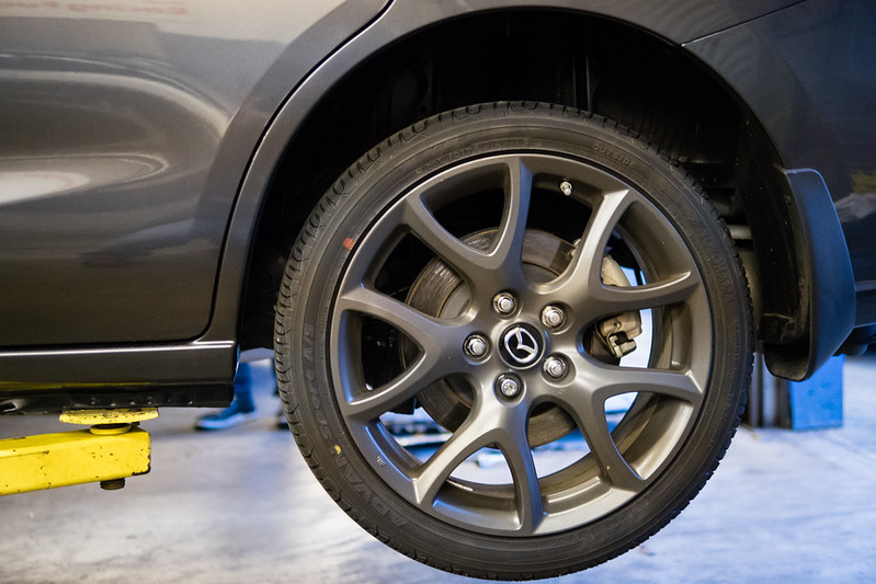

Wheels are off
P1120184 by tuanies, on Flickr

Close up of the stock strut
P1120187 by tuanies, on Flickr

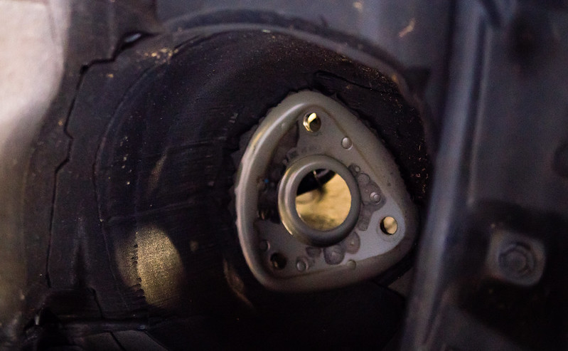

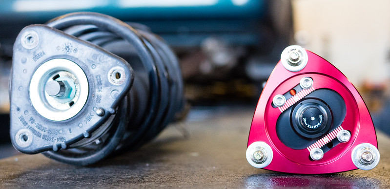

It's out! If you want access to the camber plates after installation, you'll have to enlarge the center hole of the strut tower. I opted not to do this since I have no plans of adjusting camber at all.
P1120194 by tuanies, on Flickr

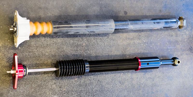

Stock strut versus the new coilover.
P1120192 by tuanies, on Flickr
P1120193 by tuanies, on Flickr

For some reason I forgot to take a shot of the coilover installed without the wheel, but here's a shot with the wheel on. The new setup doesn't have as much travel up front.
P1120219 by tuanies, on Flickr
The damper adjustment knob is easily accessible on the passenger side. The driver side is slightly annoying due to the clutch fluid reservoir but its not that big of a deal.
P1120198 by tuanies, on Flickr

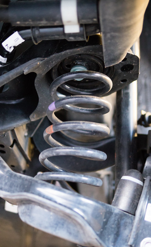

Now let's move to the back! Here's the stock setup.
P1120205 by tuanies, on Flickr
Tuanies
Aug 4, 2002
223
www.tomshardware.com
Mazda makes things very easy in the back. There's just two bolts holding the strut in place up top. No need to take apart interior trim or anything.
P1120188 by tuanies, on Flickr

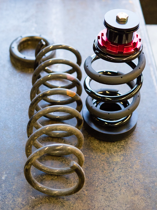

Stock spring versus new one.
P1120207 by tuanies, on Flickr
Rear struts
P1120211 by tuanies, on Flickr
Stock versus coilover
P1120210 by tuanies, on Flickr

New perch in place. We left the default settings but will have to go back and adjust it to get the rear a little lower.
P1120214 by tuanies, on Flickr
Spring in place.

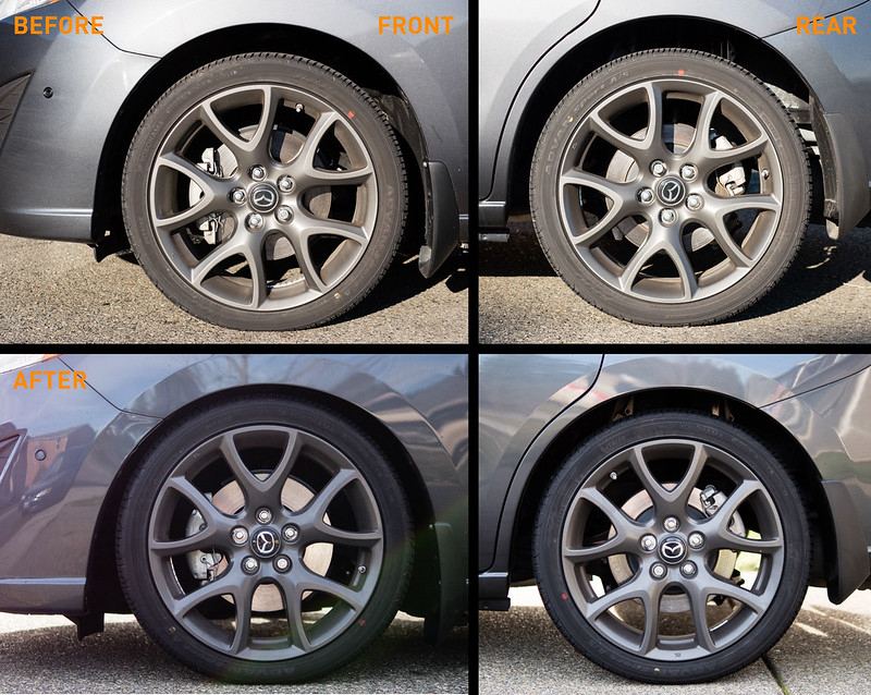

We bottomed out the front and rear struts on the car to get the car at that ride height. The front is perfect where it is for me. We need to adjust the rear spring perch to get the back end just a little lower to reduce the wheel gap.
Comparison shots.
Side-comparison by tuanies, on Flickr
Tuanies
Aug 4, 2002
223
suspension-travel-comparison by tuanies, on Flickr
fender-gap-comparison by tuanies, on Flickr
