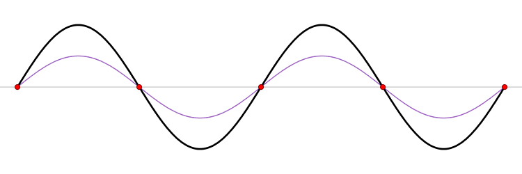

Forming a standing wave with the right wavelength that the electrons are in some sort of resonating state. Pushed by the former and pulled by the latter.
I have not read all the documentation of Mr Prins but i always thought it has to be something like this :
Assume this as a thought experiment :
The black is the vibration of the atoms. And the red and blue are the electrons . They are harmonically pushed around. That is if it is possible that a harmonic standing wave can push another wave around. As a field i think it can, but i am not sure. I have to read more about this. I just borrowed a book about high frequency electromagnetic antenna designs to learn more about electromagnetic fields and to refresh fading knowledge.

From the text :
The researchers posit that the electrons do not pair in this temperature range and instead travel in a wave; what they observed at SSRL were crests and troughs of electron density.
That sounds very similar as the plane waves model found with photons.
It reminds me of the explanation part about photons traveling as waves at time : 04.15
http://video.google.com/videoplay?d...5jt-Qbm4tmCDw&q=electromagnetic+waves&view=2#
Plane waves :
http://en.wikipedia.org/wiki/Plane_wave
It would make sense that electrons can travel seemingly united as a single wave through the right medium. A super conductor can be that medium. but maybe i am wrong though...
I just had to think of this :
The entire universe seem to be comprised of circular movement. Position turns into time when there is a boundary limit for the maximum speed any point on that given circular movement can travel. When that maximum speed is a constant, i would think that would automatically create a sinusoidal shape. Because time seems to be locked as well because of that maximum speed. Thus the time seems constant only when that maximum speed is a constant.
