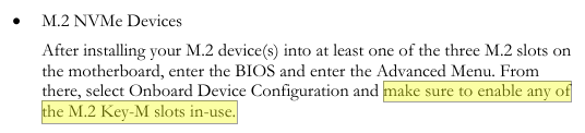

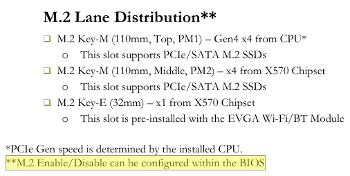

Meanwhile, I looked at the remaining motherboard manufacturers and this is what I found:
EVGA appears to have full control on enabling/disabling all M.2 slots, according to the manuals.
For example, this is from an X570 manual:
And this is from a Z790 manual:
Biostar informed me that there's no such feature on their boards.
MSI support in their very broken English tried to tell me that they support it, but I think they meant it for SATA ports. I asked someone with a MSI board to check and he said there's no such option for M.2 slots in the BIOS.
So, right now, EVGA mobos seem to be the best choice in this regard.
