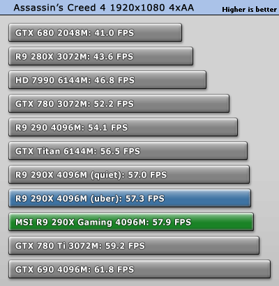

Project Cars CPU benchmark indicates very poor CPU optimization. Again we have bad FX 8150 support and i7 with 4 cores equaling i7 with six cores. Game should have at least 8 threads well optimized as Crysis3/BF4 is:
Assassin's Creed 4 last week benchmark showing good optimization for the two manufacturers GPUs on a i7 processor:
I said Assassin's Creed 3, not 4..
