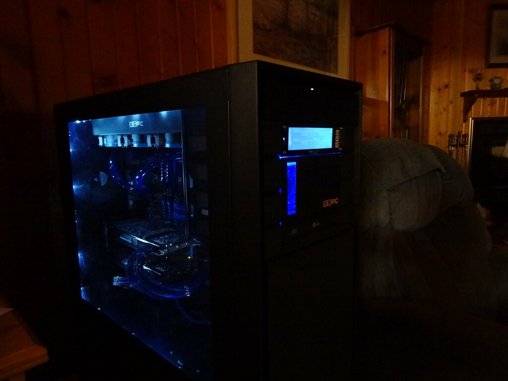

Here is a shot with my LED's installed.
I did make one funny mistake. I filled my water up all the way to the top of the res, with no room for air to bleed. I had thought I had gotten it all out, but when I sat my rig in the permanent spot, I had one pump driving me up the wall making noise. I had shook it, tilted it, spun it around and nothing made a difference. Finally, I noticed I had installed my flow meter backwaters and needed to break the line. So I used vice grips with a piece of shim on both sides of the teeth to keep from damaging my tubing. With the disconnect, I lost very little water, but after I had it up and running again, I tilted it back for something, and it sounded like a bolt was sliding across the bottom of my case. It was air in my pump, and after that, both D5's were dead silent on all but the highest setting.
Also, when I take down my loop to add graphics cards, I need to black out the top of the acrylic res. I don't like how the light escapes between that and the Aquaero.
I went with the blue led theme on my 900D as well. I added 6 LED fans around the case to illuminate the case instead.
Mine are actually white. My blue is the single LED in my res that came from XSPC, and just blue tubing. I think it accents well. I have had a few that don't like the blue tubing.
