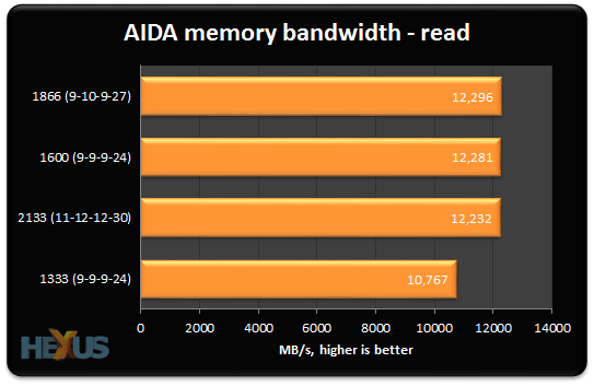

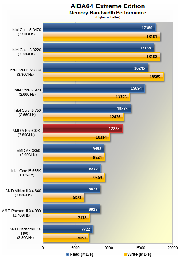

Trinity/Richland gets around 15 GB/sec according to sandra and 12 GB/sec according to ADIA64. The 15 GB/sec numbers seen do not seem as much of an improvement (the platform getting 11-12GB/sec seems to be a notebook and that is going to get lower numbers).
Those numbers seem way off compared to my 6800K with dual 1333MHz, it gets somewhere around 18GB/s read and 10.5GB/s write. (Tested Aida64 v3.20, timings 9-9-9-24)
I don't have access to 2133MHz memory right now, but based on what I have seen I'd expect around 21GB/s read for 2133MHz...
Will post screenshot, but don't have time tonight.
That would be nice! I don't have a trinity/richland chip but every review has shown around 14-15GB/sec maximum for bandwidth that I have seen and rather poor scaling over 1600 mhz.

As promised, a screen shot of 6800K memory performance:
http://imageshack.dk//viewimage.php?file=/imagesfree/QER46799.jpg
DDR3-1333, 9-9-9-24CR1 (not sure why Aida64 reports 9-9-10-24, the BIOS is set 9-9-9-24)
Read: 18436MB/s, Write: 9639MB/s, Copy: 14556MB/s, Latency: 71.2ns
I have also got a little treat for you all. 6800K performance with 2133MHz memory. Borrowed a kit from a friend... :)
http://imageshack.dk//viewimage.php?file=/imagesfree/Jx847168.jpg
DDR3-2133, 11-12-11-30CR1
Read: 21234MB/s, Write: 9984MB/s, Copy: 17659MB/s, Latency: 61.3ns
I'll have to take my hat off to AMD, 2133MHz is completely stable. It can't be easy to get a 32nm memory controller working so well at that speed. Remember Sandy Bridge?
