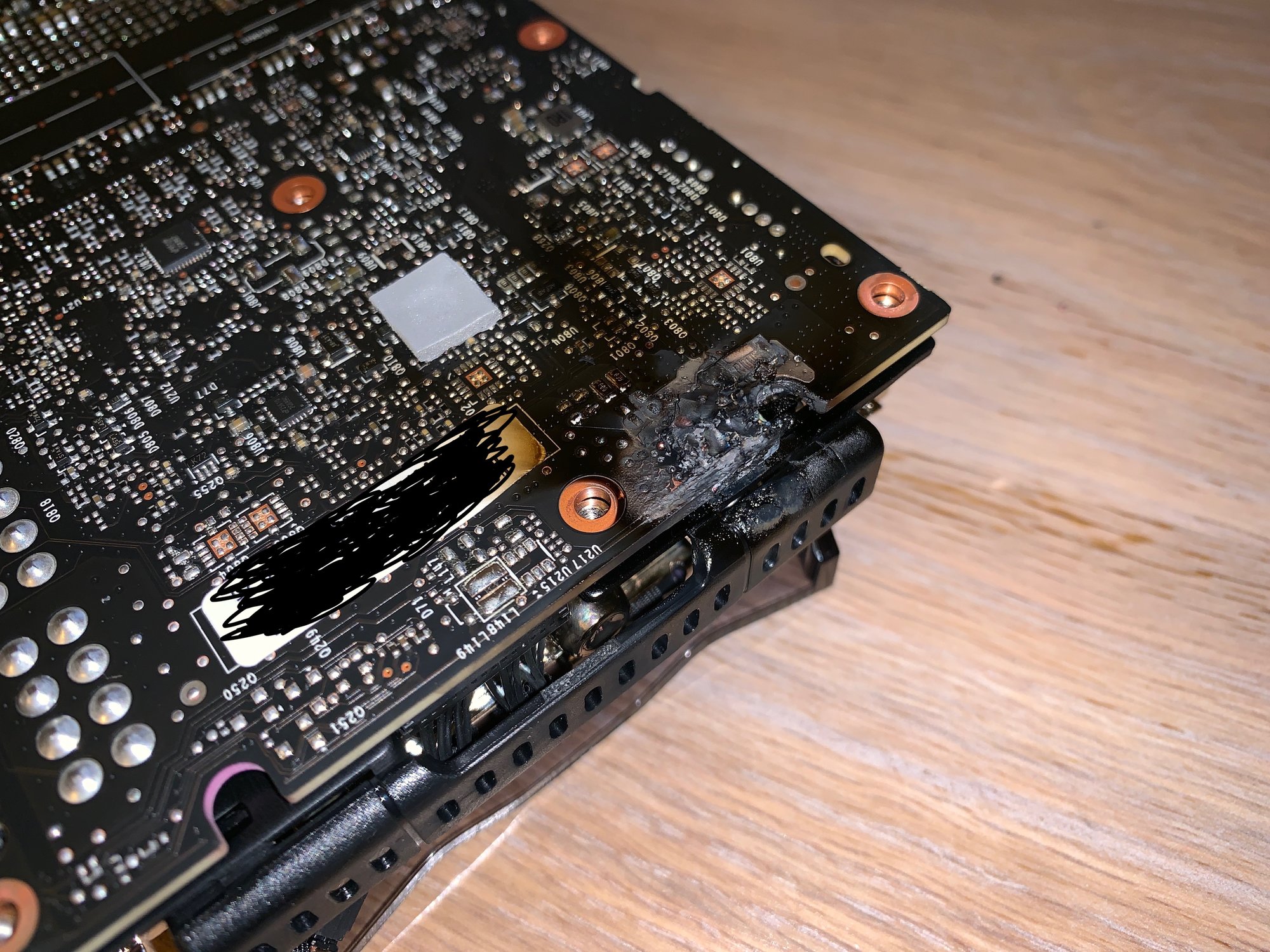

GamerNexus suggests some of the issues could be related with display dependent. I had BSODs similar to this with my 2080 Ti and my 3 different monitors blue screened on all of them.
Display controller built in GPU is taking down a whole GPU? I don't thing that's a RC of this issue.
.... or nVidia messed up display controller once again - remember Paxwell display port issues?

waiting to see the results for the artifacting cards since thats what most of the problems seem to be. 1 of mine included.

There is a user on the nvidia forums claiming to have 2080ti FE's with Samsung GDDR6. I asked for clarification if that is the case on his replacement cards. If so that would certainly give weight to the Micron VRAM being the problem
EDIT: many users now reporting their replacement cards have Samsung GDDR6 and a new bios

Kyle's GeForce RTX 2080 Ti failed over at [H].
https://www.hardocp.com/article/2018/11/09/geforce_rtx_2080_ti_fails_after_gaming_for_2_hours/

Supposedly the 2080TI has been pulled from nVidia's website because of these issues.

With Samsung GDDR6 on some failing cards, I have to wonder what the heck the root cause of failure is. This is one of the worst GPU launches of this decade.
I do hope we learn why these cards are failing, because right now I have very little confidence in the 2000 series.
If the failures can be definitively linked to the memory subsystem and can be found with both Hynix and Samsung VRAM, then the next logical place to look is the memory controller. That being said, with some of the cards going into "partial failure" mode where they can operate with limited GPU clocks, I have to wonder if the problem is the memory subsystem at all.
Either that, or we are seeing failures on multiple levels. That will make diagnosis all the more difficult.

IMO this is caused by a faulty memory VRM in the FE PCB. No reported issues with AIB cards using a custom PCBs so the GDDR6 chips themselves are probably not to blame. FE PCB could be sending voltage spikes to the vram causing damage over time.
There have been AIB cards failing as well.
