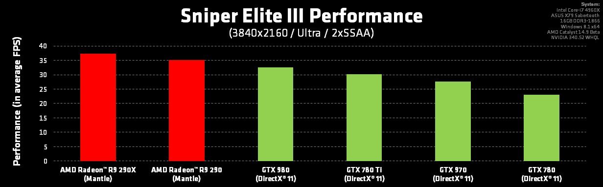

Seems to work pretty well...
Courtesy of Rebellion's own benchmarks....^_^
96Firebird
Nov 8, 2010
5,747
342
Judging by that chart, they used a driver that doesn't even support the GTX 980 or GTX 970...
