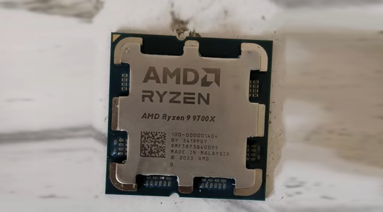

I think AMD did some additional quality testing in light of the ongoing Intel fiasco and reflected, "hey there are some niche situations where we might have similar problems." They are recalling the parts and re-binning to assure quality. Good on AMD.
Turns out they had a packaging typo that could not be ignored. Maybe this wasn't their only issue, but it still shows that assuming they have problem X because Intel has problem X is not the best course of action.

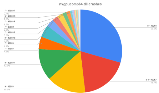

Just how affected is the 13600KF?
It's a prematurely discontinued SKU: https://forums.anandtech.com/thread...engine-games-and-others.2617728/post-41259878
My conspiracy theory: https://forums.anandtech.com/thread...engine-games-and-others.2617728/post-41255879
A most punishing game: https://forums.anandtech.com/thread...engine-games-and-others.2617728/post-41251012
I think the Core i5 "might" be safe based on this image:
