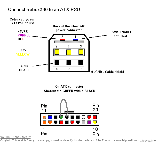

damn, that sucks. Is the light on the power brick on?
if you have a multimeter you could check the output pins on the power supply to make sure they have the correct voltage
