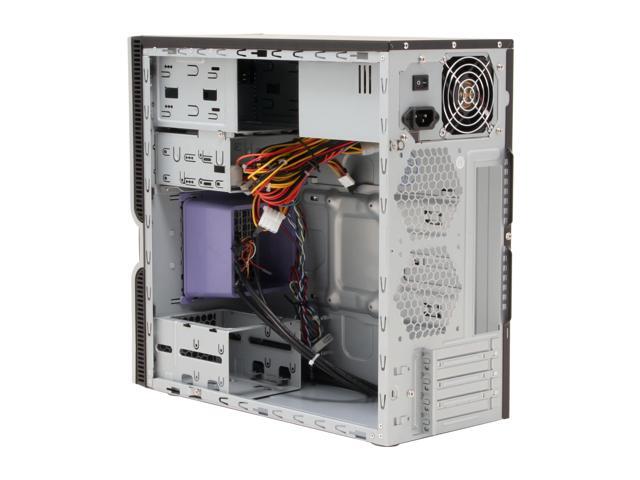

I'm going to take a wild guess here, since I can't see enough detail from your photo.
Assumptions:
1) the heatsink is fastened down with screws that have springs under their heads.
2) the screws are designed to screw down until they bottom out.
3) the motherboard has fairly big holes, and the screws are supposed to pass through the holes so that when they eventually bottom out, they're bottoming out on the threaded metal bewbies under the motherboard, which would be part of the chassis metal. Like in this photo here.
Now my theory is that one or more of these screws is not lined up with the hole in the motherboard itself. So instead of passing cleanly through the hole in the motherboard, and bottoming out on the metal below the motherboard, instead the screw is landing on the motherboard and bottoming out on the topside of the mobo. This would reduce the compression of the spring, since the screw is not fully bottoming out. And that would lead to the heatsink not being held down squarely.
Maybe I can render an example if this isn't clear. trueSpace powars, ACTIVATE!!! :Q
